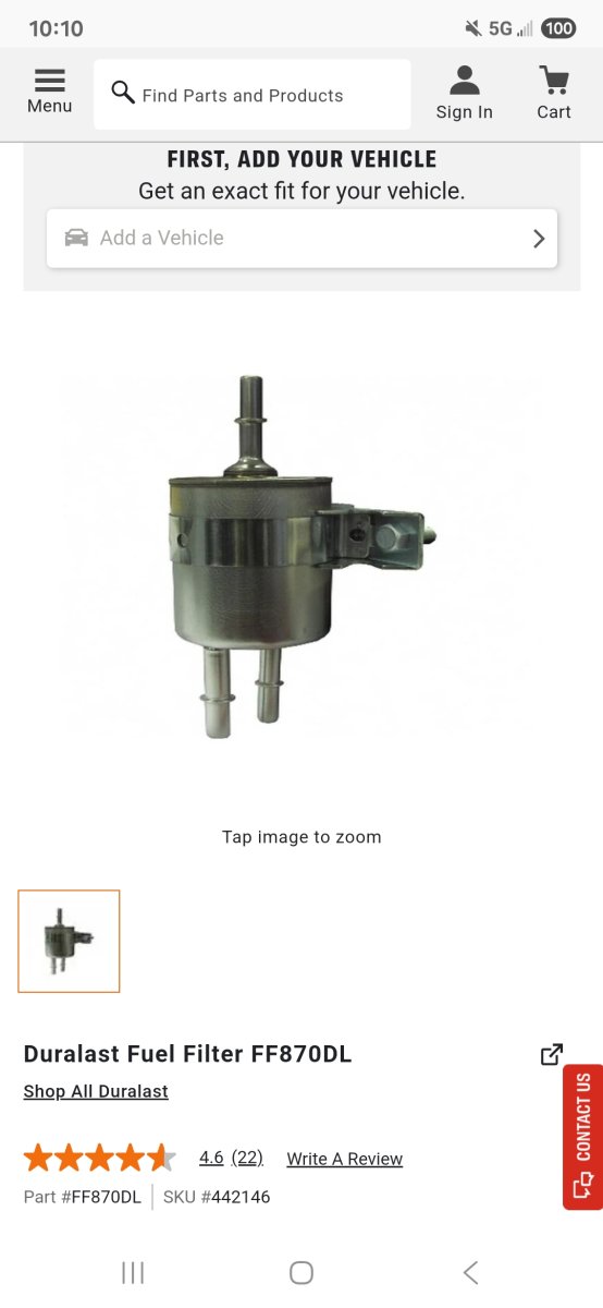

2001 3.0 RWD flex fuel. Ordered a new fuel filter with the flex fuel designation. All sites show it to be a larger canister. Went to swap it onto the truck and it has the smaller canister. Anyone run into this?
FWIW, I did install the new Wix fuel filter, it fit all the lines perfectly, no leaks, etc. I bent the bracket open as far as possible and used 2 stainless steel zip ties to secure it. I can't find a single picture of a large canister fuel filter with a larger size bracket on the entire web. Surely I am not the only person to ever have this issue.........

Wix 33667, it fits all 3 lines fine, just the holder bolted to the frame is for a small canister. I will keep using the filter, just swap out the holder. Truck had a stumble/idle issue here and there after lots of work (IAC, cam sensor and synchronizer, plugs, coil, wires) the idle stumble went away after the fuel filter change.

Problem solved. I removed the factory bracket, spread it apart slightly, used a 2.5" hose clamp (cut a strip of rubber 1/4"×4" and used that between the clamp and filter). Ran the hose clamp behind the factory bracket, basically sandwiched the filter into the oem bracket, then reinstalled the factory bracket through the frame. Looks great and very secure.
