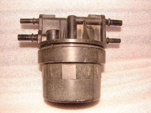

Could someone tell me which fittings go to where on this stupid thing? I think I spent money at the parts I didn't need to.
Well, there should be an arrow on the top or bottom that should point towards the front of the vehicle, probably says "flow" near it, and which line goes to which fitting on each side, they are different sizes, only gonna fit one way.
My issue is I put a fuel cell in my truck. With a inline filter before the HP pump. I still have the accumulator on the truck and I can't read anything on it. I can tell where the lines going out the front go but I need to know which line is the supply to the pump and the return from the fuel rail coming out the back.
The larger fittings are supply to the motor and the others are return.
Thank you. That's what I was hoping to hear.
