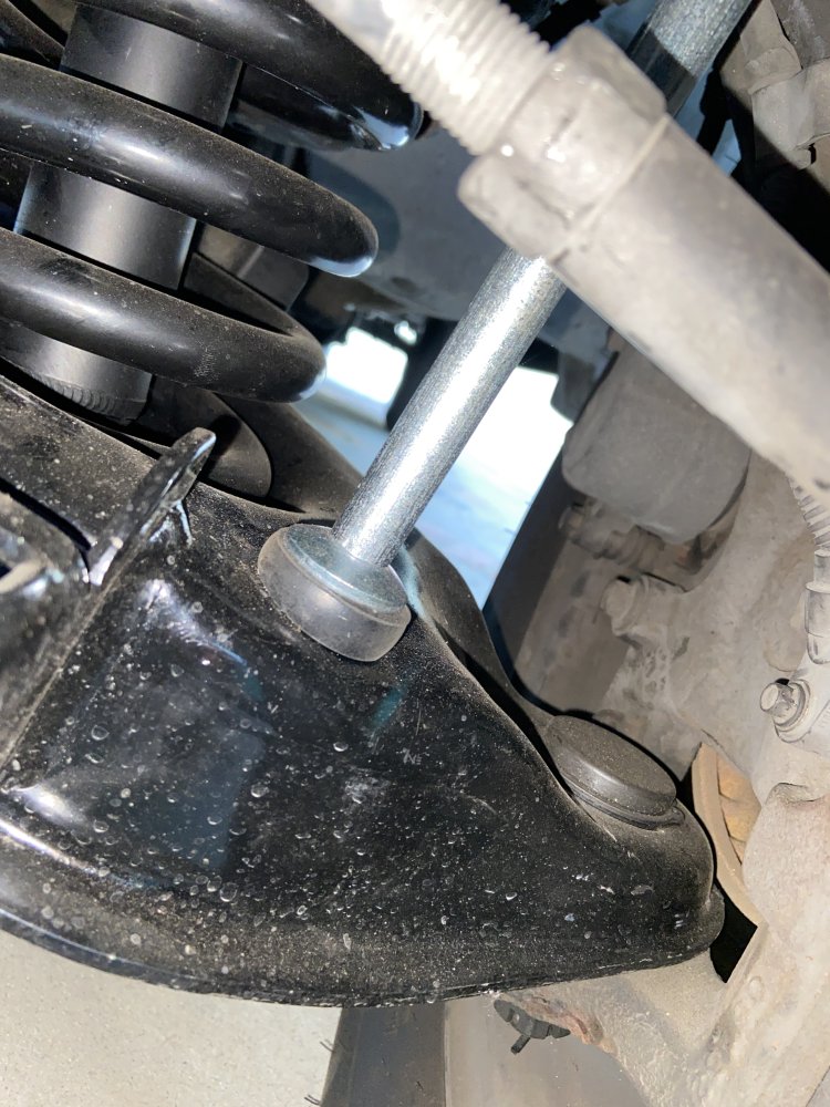

I replaced my sway bar links last month and noticed the drivers side bushings were completely torn up after 300 miles. So I replaced with new ones and 15 miles later, the upper bushing - the one on top of the sway bar is already cracked again.
I thought I might have torqued them up too tight the first time, so I checked with a mechanic and he advised 15 - 20 lbs-ft. So this time I checked both sides were 17 lbs-ft. Upper and lower Control arms and ball joints are brand new. Shocks are brand new. Coil springs are brand new. Tie rod ends are in good condition. Sway bar mount bushings appear to be OK. Passenger side link is fine.
Does anyone have any idea why my link bushings are getting torn up so quickly?
pics please, and check out the metal surfaces for nicks, gouges or stuff that snags.
I thought about that when I put them in. Everything seemed quite smooth. Looks like the lower bush under the control arm has split again too.

I agree with Bill, all visual signs point to them being over tightened when installed.
Thanks very much for the advice. Thankfully they are relatively inexpensive and super easy to replace.
the cupped washers should be as big as, or bigger than the bushings.
when the ends cycle they move in an arc, not straight up & down.
that puts pressure on one side and cuts into the bushing.
