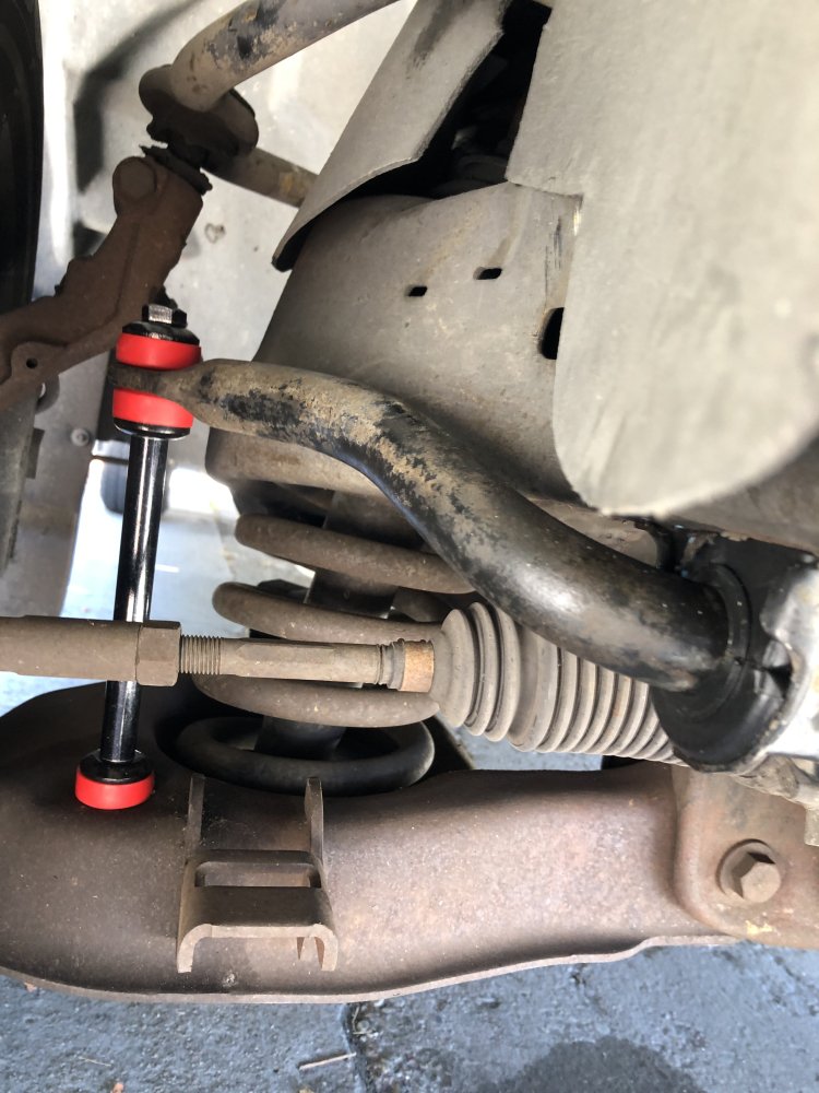

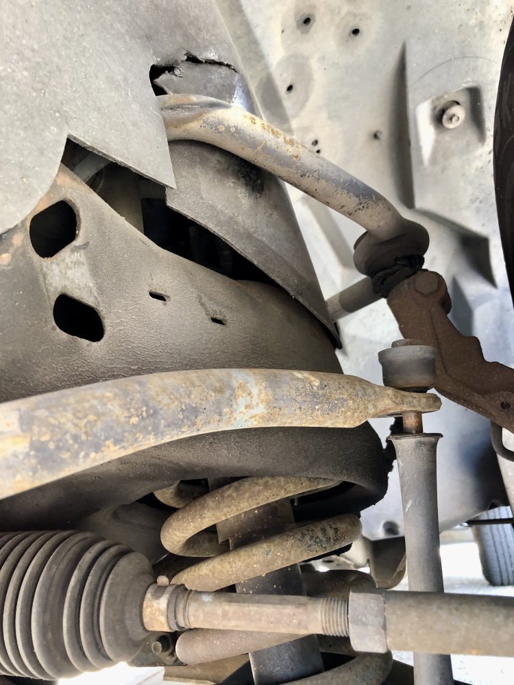

before and after pictures.

Hopefully I was able to get those sway bar ends on tight enough..they didnt' really squish down alot .. they did a little.
