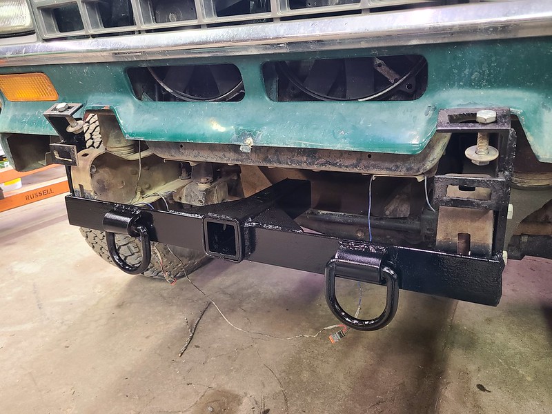

I usually make my own by adapting an existing rear receiver or using a receiver tube from Princess Auto (Canadian Harbour Freight) and some other metal.hanging around.

I made my own but my truck is a lot different than yours (and has a bodylift so the bumper sits higher off the frame than original)

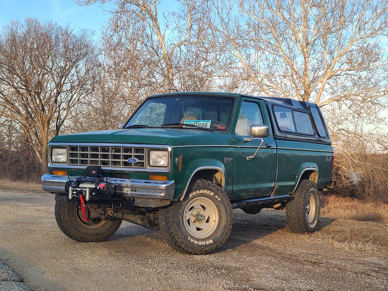

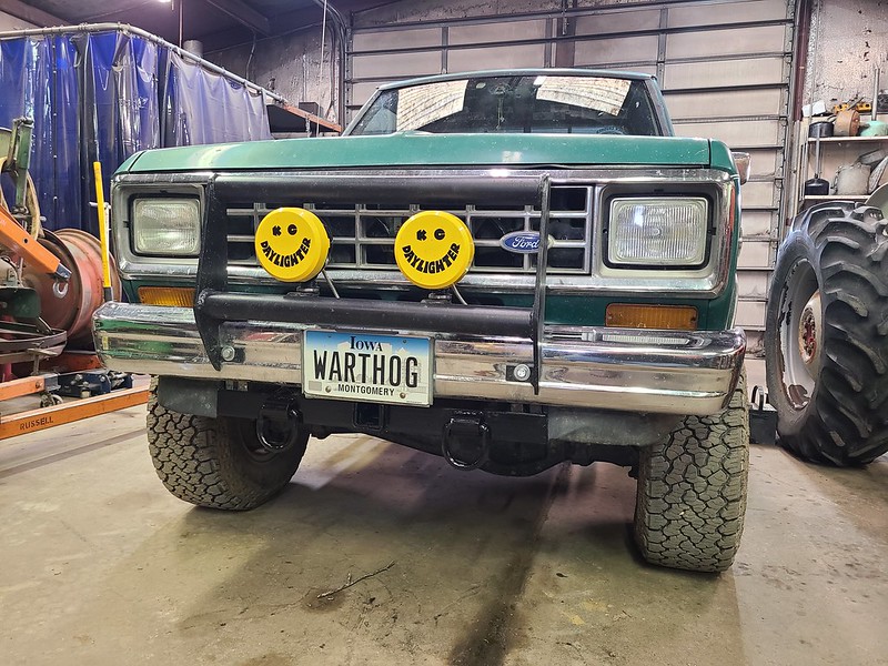

I made my own, built into my custom bumper. I don’t snow plow, though. It’s mostly used as a recovery point. I used to have a spare tire carrier I could put in it.

I make my own bumpers, BUT, to do what you are doing I would get an adjustable front or rear receiver from e-trailer that fits a 34" wide frame (older F series and E vans).
Like this hitch I bought for $10 at an auction, looks like it will fit my 1989 F-150. One tube slides within another and is fasten in place by (2) 5/8" (?) grade 5 bolts on each side.
More then enough for what you are wanting to do with your Ranger. I would certainly back the nut side of the frame with plate if not an actual left to right cross member. I posted pictures here how I bent a frame with a tow hook by not having it backed up. Got the stuck F-350 out though ...
