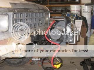

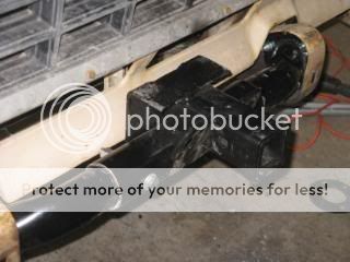

I did that on my '85 b-II, these are pics from my prototyping stage. I picked up a universal receiver for C$35.00 at Princess Auto [Canadian Harbor Freight] I've since finished welding them and they are still removable;
Unfortunately my winch got 'BORROWED' and I haven't had a chance to test the receiver yet. I'm going to build a custom bumper for it. In your case having the receiver on hand and doing measuring to see if it will fit with the stock bumper would be essential to a good looking job.Personally, I don't care about looks too much.
Good luck,
Richard
