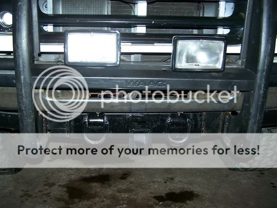

I have it mounted right between the frame rails. I have a Body lift so the bumper sits up a little higher than the fram so it worked out perfect. I'll try getting pics of it on the truck tonight
that high lift bracket is sweet!
what weezl said x2 !!!
and i do like that front hitch you made. i have a front brush guard and not sure how well something like that would mount up really. would love to ditch the chrome front bumper for something more substantial with a hitch.

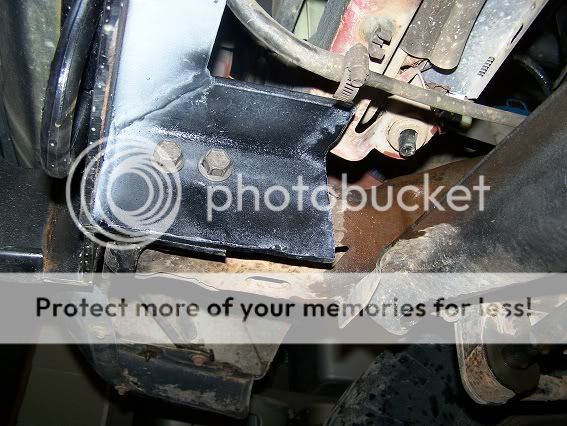

Well some of you seem interested enough so I'll post these pics here with the reciever on the truck:
Front hitch reciever DONE!
Thanks, I think it came out better than I ever imagined...It looks good and serves a purpose

what material did you use for that if you dont mind me asking?
thanks
Used 4" wide channel iron, 2" ID square tubing, and some weld on d-rings.
thanks man. gonna build one on sat then ahaha. i had a different idea in mind but urs is alot better ahaha
