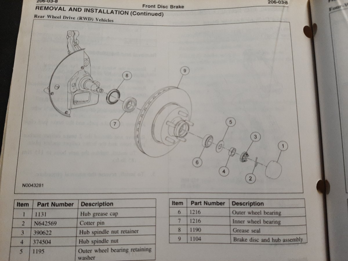

On the 2wd trucks the brake rotor and hub are one solid piece and cannot be separated, so you can't replace the rotor without also replacing the hub. You should replace the wheel bearings when you replace the rotors and obviously the wheel seals as well.
As fsr as the seatbelt i believe LMC truck sells them.

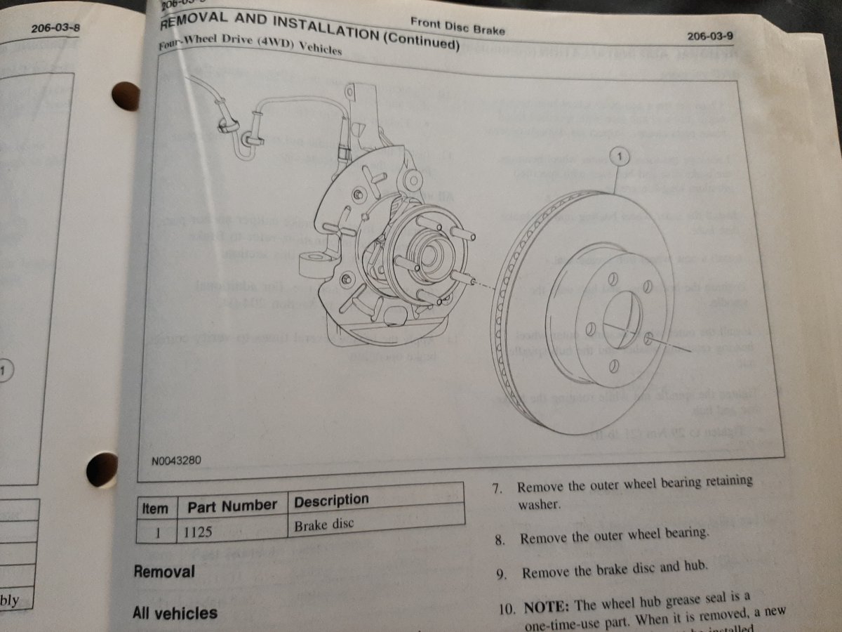

The 2wd drive trucks with torsion bars use a slab rotor and a hub bearing like the 4wd trucks. So to the OP... do you have coil springs or torsion bars for the front suspension?
I'm only getting a listing for the two different size rotors on the RWD trucks and both show a rotor/hub one piece unit but I don't have a torsion truck so I'll refer to gump on this one. Either way should be easy to tell which type you have.
So what you're trying to say is I'm wrong?
There are 2wd versions that have torsion bars just like a 4wd... they have slab rotors.
Not at all. Read the edit. Just showing what's in my manual for reference of the two types.
Our truck has the front coil spring suspension
Then you definitely have the one piece rotor/hub assembly as shown in the lower picture. There is still a 10" and 11" rotor. You need to measure but I believe only the 4.0 super cab trucks have the larger rotor.
I took the wheel off and used some squares and the current rotor looks like it's a little larger than 11"
Then you got the biggy rotors.
