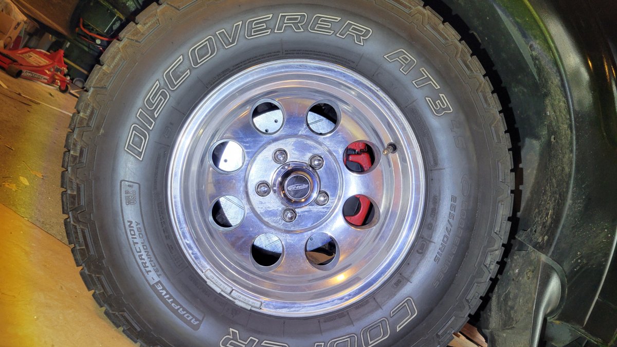

My front wheels have lots of brake dust on them and i haven't even driven very much. Wondering what is most likely the problem. Bad brake pads, or bad rotors etc...
I know i have new brake pads in the back in the rear end. But i don't know what kind of brake pads are in the front of the truck.
The truck had 177000 miles on it before the swap so wheel bearings could be bad. Could bad wheel bearings cause excessive brake dust? One wheel bearing had some play and got greased. That side has the most brake dust.

These are the reasons off the top of my head why brake dust could be heavy. It is normal for front wheels to get more brake dust since on average 70% of your braking is done by the front. The type of material that the pads are made of make a big difference in brake dust. I've had sets of pads that were worse than others. I usually get low dust pads to prevent the buildup but the down side is that they don't seem to grab as well. Its a trade off.
Crappy cheap metallic brake pads.
Always get ceramic pads.
My Motorcraft pads dusted like crazy on the Ranger. Are you noticing any symptoms of brake issues? Do you smell burning friction material? Does the car pull to one side? If you touch the wheel (not the rotor or caliper ouch!) after a drive with minimal braking is it hot to the touch? It might be time to buy a carwash subscription or some wheel cleaner like HotRims.
Cheap pads. Not necessarily semi-metallic.
Certain years of factory Ford pads were a joke for this, others were fine.
I do smell a metallic smell after driving the truck sometimes. No major brake issues and no pulling to one side. I don't think my steering wheel gets hot. I will check that.
I suspect the wheel bearings are bad and probably cheap pads are on there. I didn't put them on whatever they are.

I don't know, but I installed slotted and cross drilled rotors, I've noticed that they stay clean. It might be that they are just new and haven't been scored too badly from road dust and debris. It might also be that the holes and slots tend to whisk away the dust. I'm sure they will clog up over time and that they may need to be cleaned.

I'm betting it's the pads. Ever since I switched to ceramic pads, brake dust on the wheels has been minimal. Build up still happens, just no where near as bad a cheap brake pads.
Witch Motorcraft pads dusted like crazy? No brake issues but there is a metallic smell and the truck doesn't pull at all.
What brand ceramic pads did you switch 2? How many pads are in the front of the truck? I will look them up.
I don't remember. Powerstop, maybe? Raybestos? As long as they are a name brand, they should be good.

My brake pads were at 20% as it turns out so that must have been the source of the dust. I got some ceramic brake pads. Don't know what brand. I have to ask my mechanic they were 70$ though so that sounds about right. I asked if my wheel bearings were doing okay and he said there not making any noise but that he didn't take them apart. I bought wheel bearings for the future if they become an issue.
So hopefully that will solve the brake dust issue. Hope that is the last issue for a little while.

Anyway brake dust issue is solved, bad pads replaced, for now unless there is something else wrong with the brake system.
