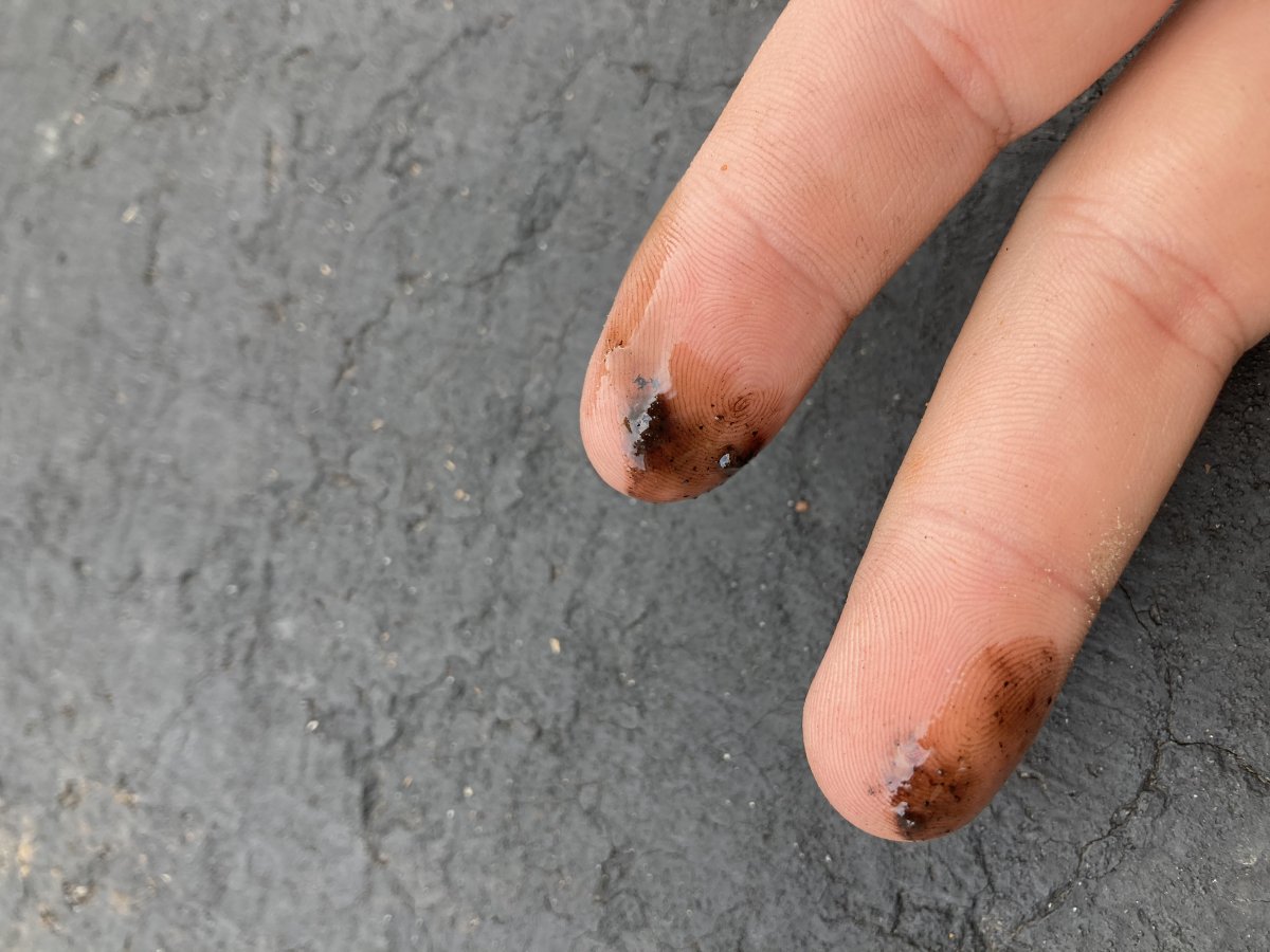

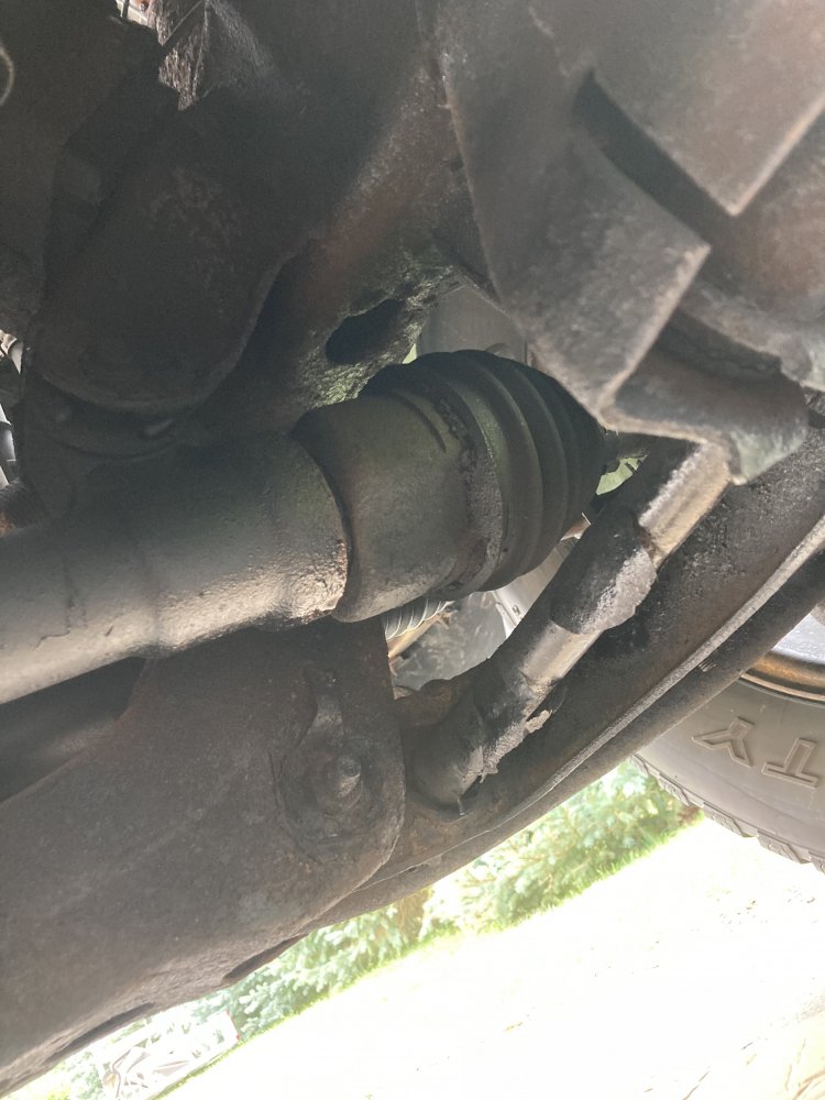

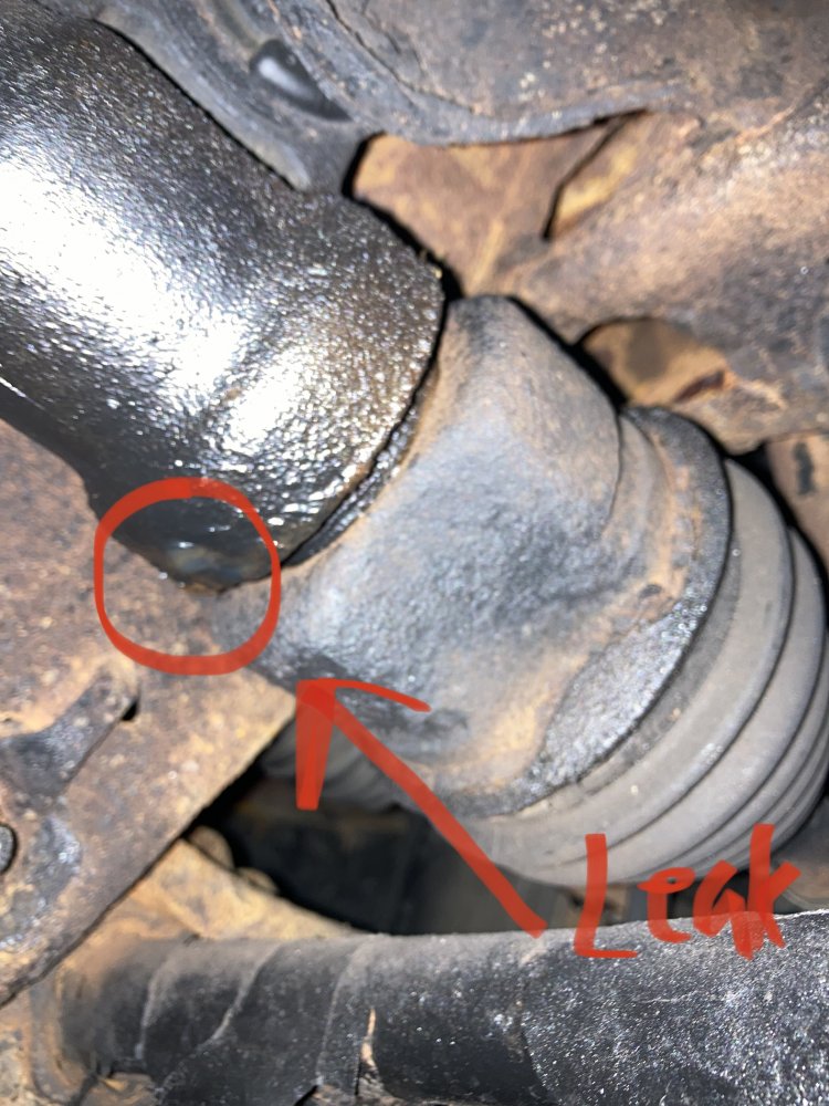

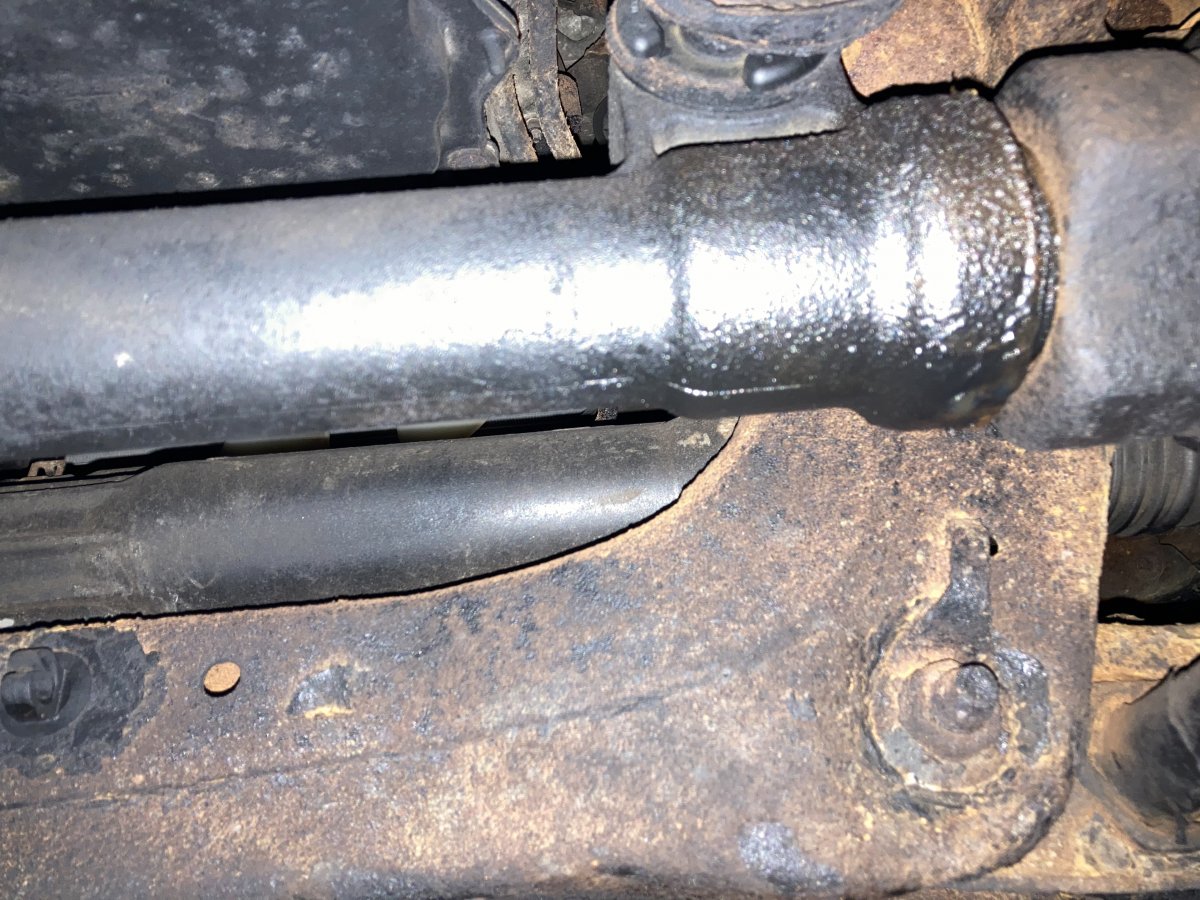

Yesterday I noticed a leak coming from around the front differential on the passenger side towards the passenger wheel. It has been a very slow leak and grimy/dirty. I’m guessing it’s differential fluid and not oil. I’ve been checking the oil levels daily and they are fine and have not gone down. I have had this truck for almost month and this is the first time I noticed the leak (I have been checking for leaks everyday). I usually park on flat ground at my house, but my truck has been parked on an incline the last two days, if that would make any difference.
I have no smoking oil in engine or oil leaking from other components as of now. Hoping it’s just a seal that can be replaced!
I’m wondering if the issue is an Axel Seal Leak which is causing this? I’m talking it in to a trusted shop Thursday to get it looked at. Hopefully it’s just the Seal and differential fluid and not an oil leak.

Yup thats a leaky axle seal but it looks like youve got a slow oil leak as well judging by the crud on your oil pan.
