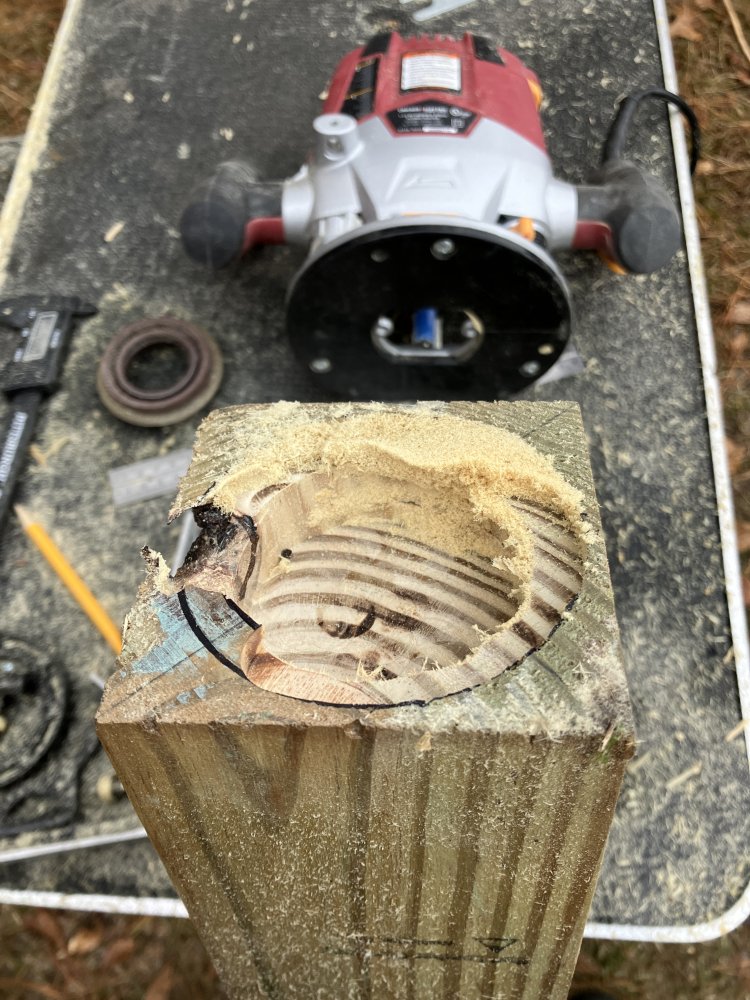

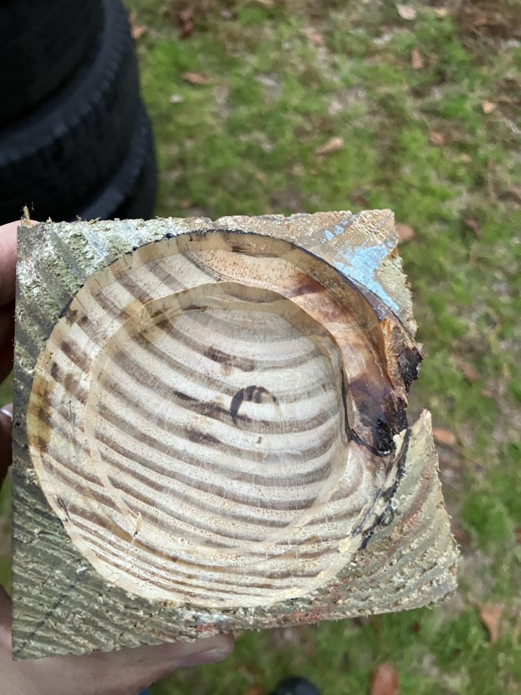

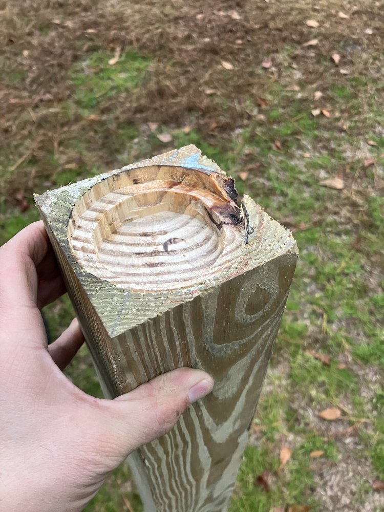

I was getting fed up trying to start the axle tube seal. Every tool that claimed to be a seal driver would crush the ridiculously large cone that extends from the seal. Every tool designed specifically for this seal was stupid money. There was no room to swing a hammer to start it with taps around the flange. So, out of a piece of 4x4, I made this “tool” to hold the seal in position, protect the cone, and get it started. You put the seal in the end of the post, then slip the end of the post over the axle tube, then whack the hell out of it with a sledge. The mass of the post absorbs a good bit of your striking energy. But, being wood, the seal end is gentler on your seal and axle.

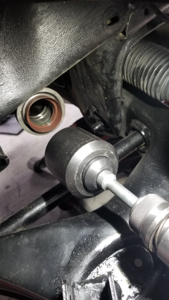

I've seen people put a threaded rod all the way through the axle housing with cups/washers/nuts on both ends, with both new seals and just tighten the rod and it pulls both seals in at the same time (you could do one at a time this way as well). Allowing you to start them slowly and be able to continually adjust them to begin perfectly straight. I've never done it, but it is a fantastic method, which also reduces the risk of seal damage by like 99% compared to striking of any type.
After fighting them various ways in the past, I eventually found to use pieces from the snap on BJP1 set which just happens to have the perfect size cup for this seal, using an air hammer on the LOWEST pressure setting, it will walk them in very gently in a couple seconds.
