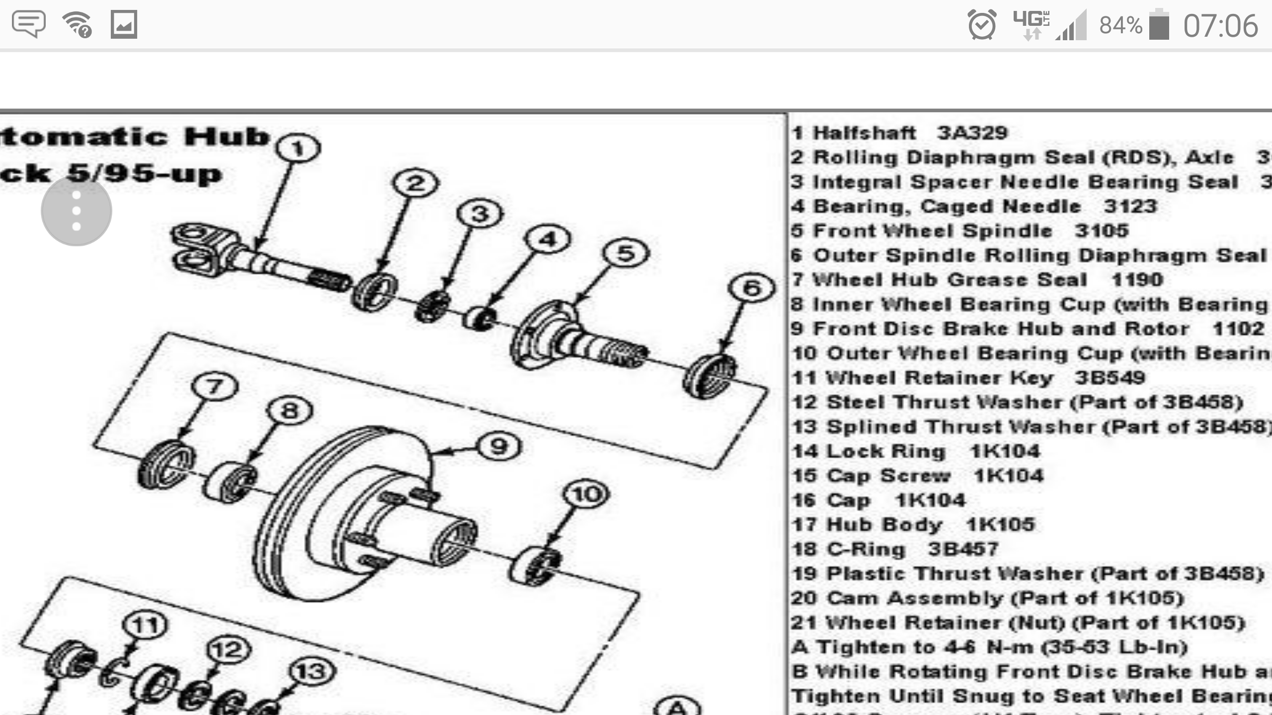

Good Morning All,
I upgraded my hubs to the larger warn 37780 manual locking hubs.
I am in need of a part or part number,
It is the seal (or gasket) on the outer spindle axle cover
It is not the grease seal behind bearings on the Rotor,
But on the outer spindle that the rotor sits on, it sits on the back lager part of the outer spindle,
It is the item number 6 on the attachment (picture).
Any link or help would be GREATLY appreciated,
This is holding up my project.
That You,
Robert
  • 1995 Ranger 4wd Front Outer Axle dust seal/gasket
I can't find any mention of that seal apart from the image you posted. Every other one I have come across doesn't have that part. I have taken apart many Dana 35's and haven't seen it. That doesn't mean it's not out there though. :dunno:
I am trying to figure out the purpose it would serve, because the seal that goes into the back of the rotor is what holds the bearing grease in.
That seal(in the back of the rotor) is number 54 in the below diagram and is part number 4250
Try SKF # 25013. I think they only used that seal on late 95 + 96 trucks.

Yes that is the part #SKF 25013 I have been searching for.
And yes, it was a added part only for the Ranger 1995 - 1997
