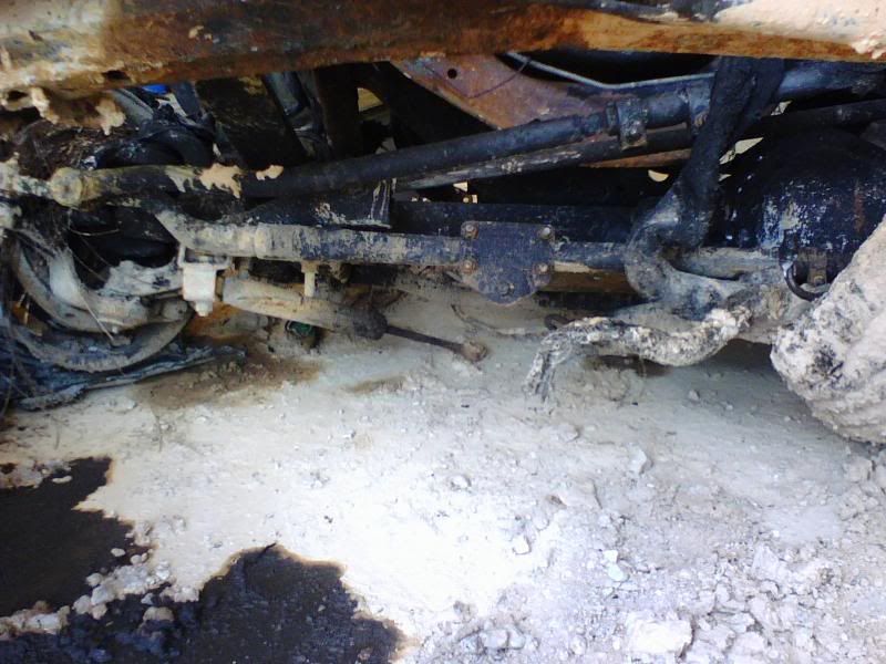

A friend called monday from the local scrap yard to tell me they brought in a smoked F250 with some 60's under it,could they be warped or bent from the heat?
Looks like it got pretty hot!
Possible T-Case?
What do you guys think?
Dont have a price yet,should know tomm.
The F250 super duty's had D50 in the front not D60. So I'd pass.
Thats not good!
I didn't have a lot of time to check it out.
Not doubting you but I'm going back to check it out,it should be on the tag or stamped in the case right?
Depends on year ('99-'01 had the D50). Check the pinion nut size: 1-1/8" = D50. 1-5/16" = D60.
Also, there's only one 60 under those trucks if it does have one (rear is a Sterling 10.5").
Take a very close look and try to note if all the seals are still in the axle and are nothing more than just singed from any heat (pinion seal, boots on the balljoints, u-joints, etc.). If the seals are still there, I'm thinking chances are pretty good it'll be OK. If you find any seals looking pretty cooked though, I would suspect the whole thing probably had gotten hot enough to affect it's integrity.
I am willing to bet that the whole thing is probably still good judging by how there is still rubber left on the front tires......

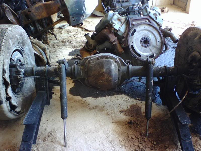

Went back to the yard today an took some pics and taled to the guy that took in the truck,He says it was a 04 05.Took a few pics but the damn engine is still sitting on the frame so its hard to get to it.
They just torched the frame behind the engine and in front of the rear spring hangers.
The BOM # on the front is V611071-1 with 3.73 lc3 ja on the tag
The rear tag reads 3.5 409 h with l73 10.5 0m11 under it.I can get both axels with springs,the c-6 with the 205 for $350.
Outters...
Pinion...
Any info would be sweet!
