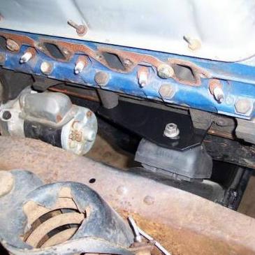

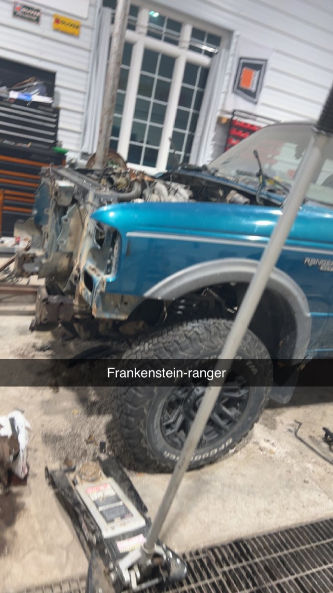

Hey what's going on y'all. as you've read I'm building my 96 ranger into a trophy truck. I've currently got the 351 in it and the zf5. I'm going to carb swap it from fuel injection though i don't really want to deal with the electronics. my question is how are y'all keeping your trucks cold? im thinking of relocating the radiator to behind the cam in the bed but id have to run pressured coolant lines to the front and as we all know itll get warm again. any help is appreciated. Thanks
