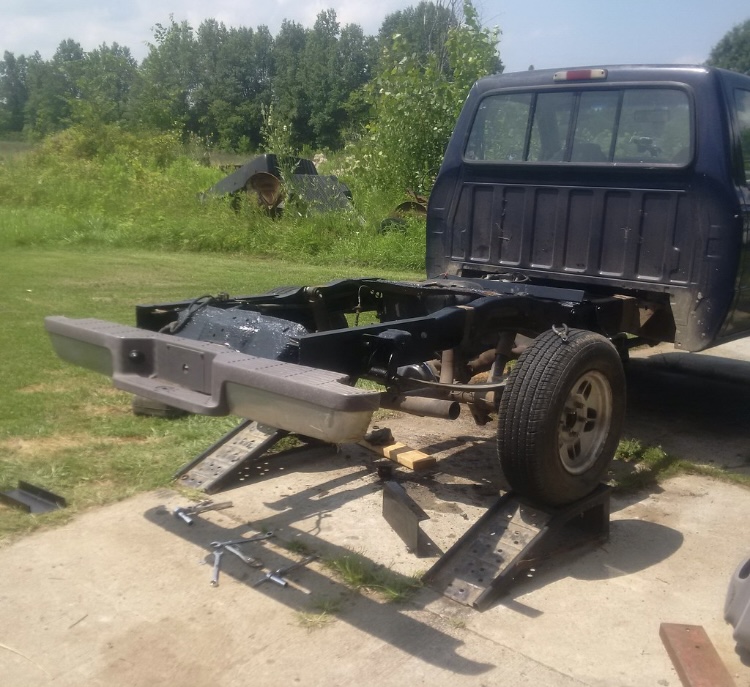

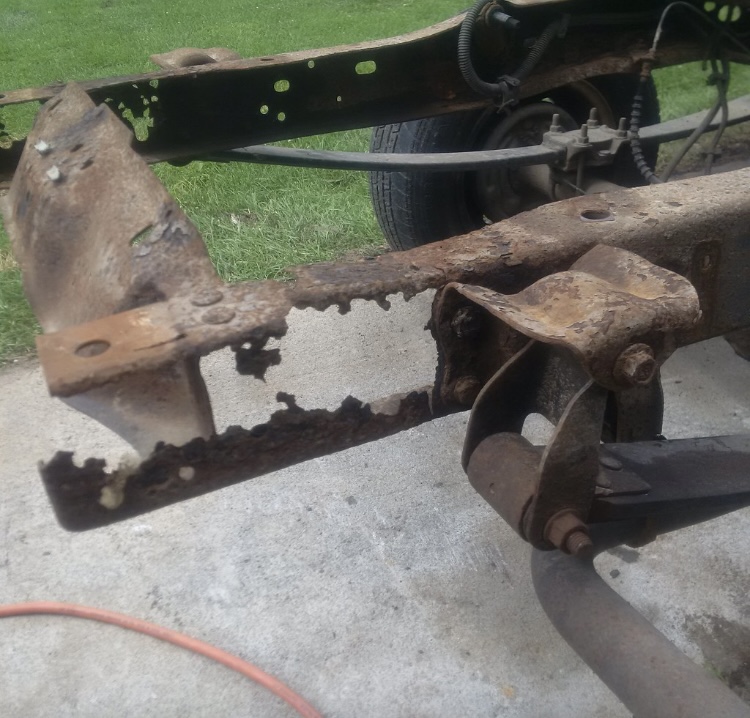

When you go to air-chiesel off your spare tire carrier & it rains rust , then frame rails look like cardboard that got shotgun fire, you need some new or at least better steel.
Clean good and por-15 it all once repaired.
Well ya know it’s bad if you have to air chisel out your spare! :shok:
I just didnt want the under-bed carrier, dads torch set was out of O2 so the air chiesel seemed to be the best tool to use.
Yikes! From the looks of the frame in your picture:
hey- that was over 5 years ago and is still daily driven to this day. Ive had to patch one other spot, left side where shock bracket mount is.
I think you could have just kicked it or looked at it real mean and it would have fallen off.
back bumper was barely hanging on, and it had a hitch ball on it. It was truly a junkyard dog when I bought it. Id love to find the kid I got it from & show him his old truck now.
Actually, I think that you did a damn good job salvaging what was left of that frame.
