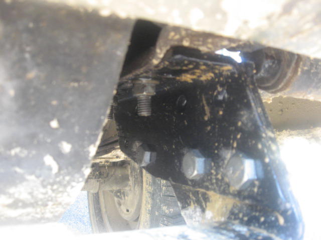

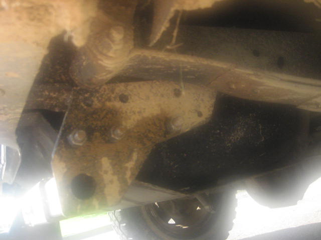

I have one. It was on the truck when i bought it. I think it has about 6 bolts holding it on.
Ok from the back.
Under pass side.
And under driver side.
It is held on by just those 4 bolts.
Its a draw tight. Its kinda smaller than most, it's only a 1" receiver but its rated at 3500 pounds trailer weight.
