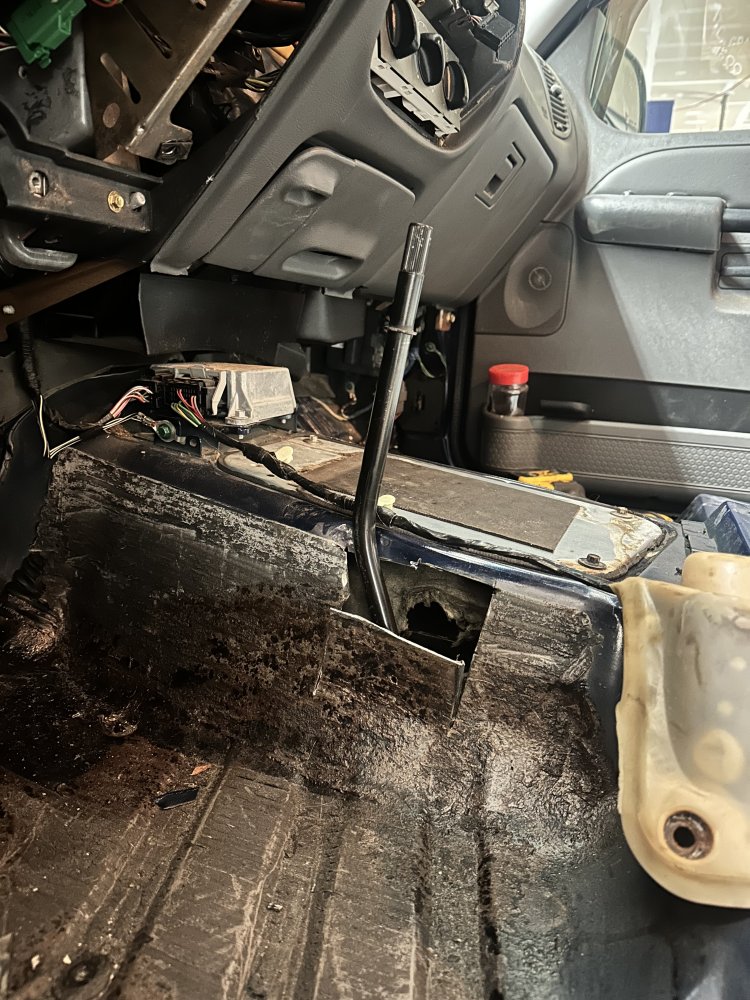

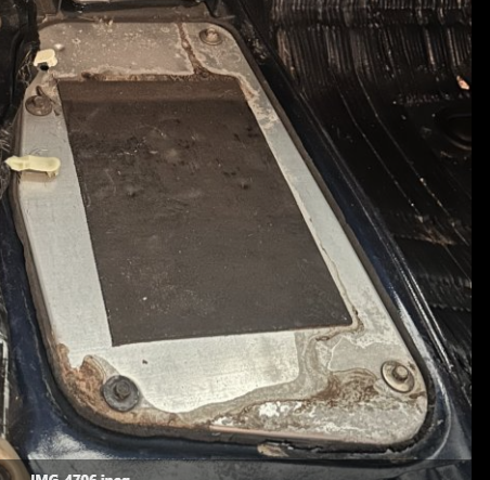

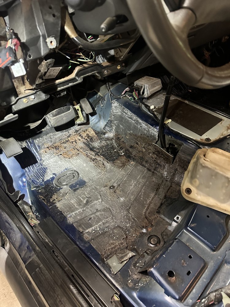

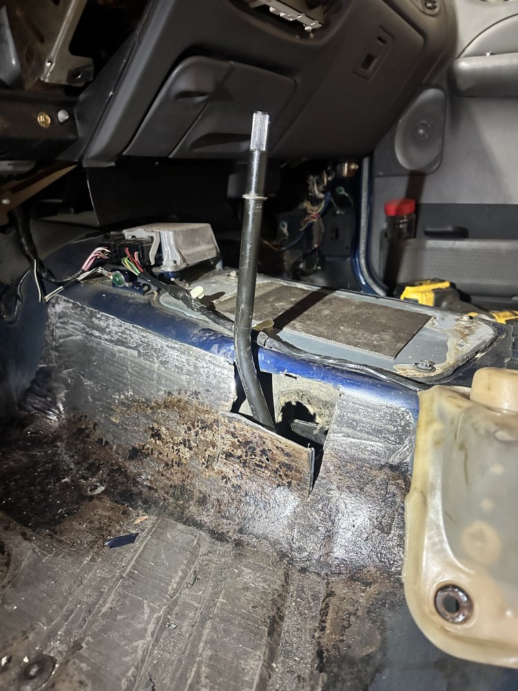

Got the rear driveshaft made and now I’m finishing up the manual case shifter install. Been a hectic few weeks, but I’m almost ready to take her on her maiden voyage!

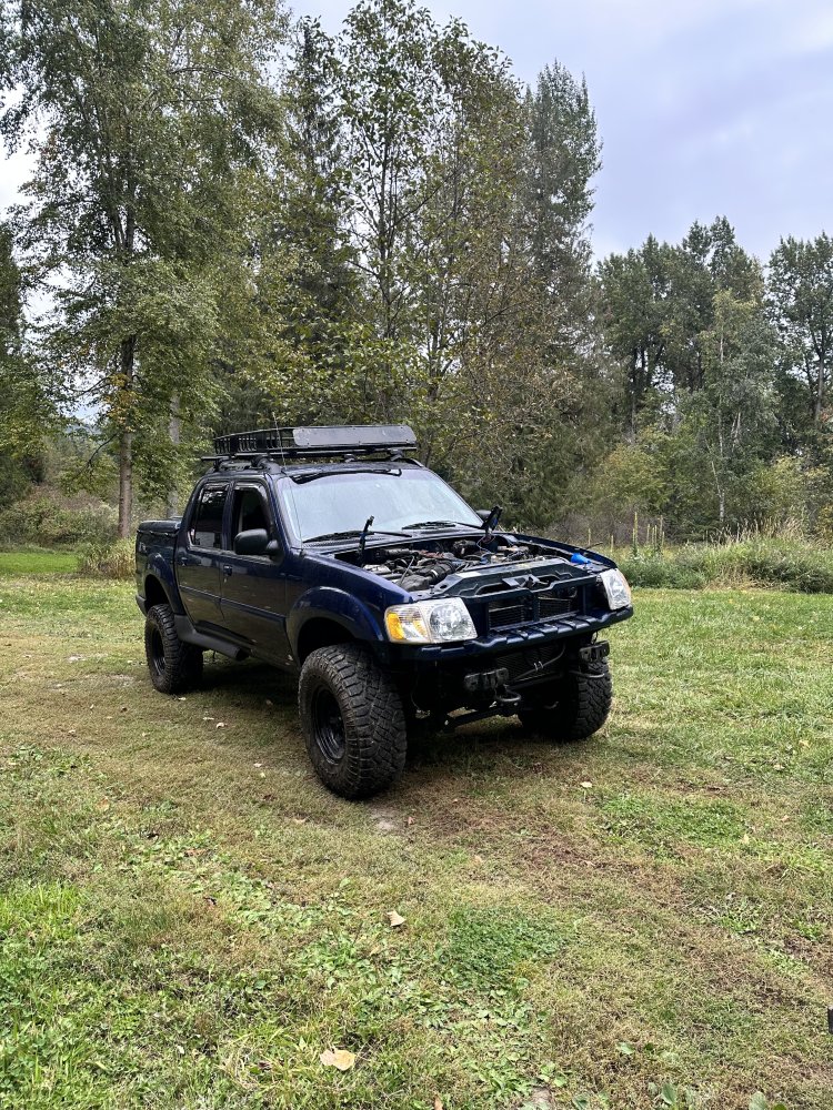

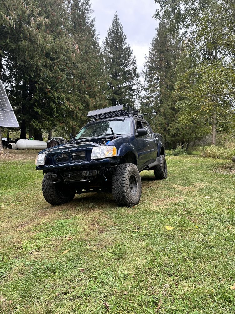

Got the U-joint installed finally and let me tell ya… best and worst test drive ever lol
After a few mishaps and little bugs, we got it to a point that all we need to do is cut/modify the plastics for tire fitment, get it aligned, and wire up the Dakota digital box so I can have a speedometer and the wife will be driving her new truck finally lol

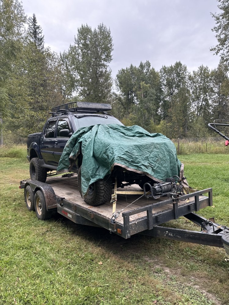

Headed to get this thing aligned! Fingers crossed! Tarp is on cuz I started raining! Lol go figure

Got it aligned and well….. I’ve got some bugs to squash…. The transmission won’t shift into 3rd and it’s got some serious death wobble. Time to start fine tuning

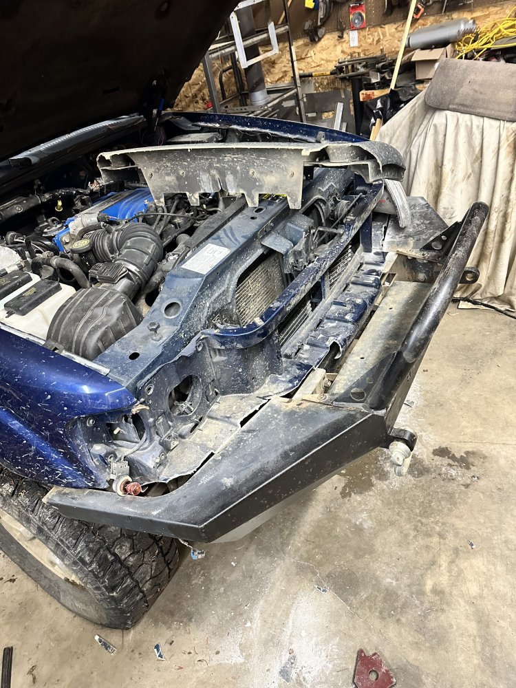

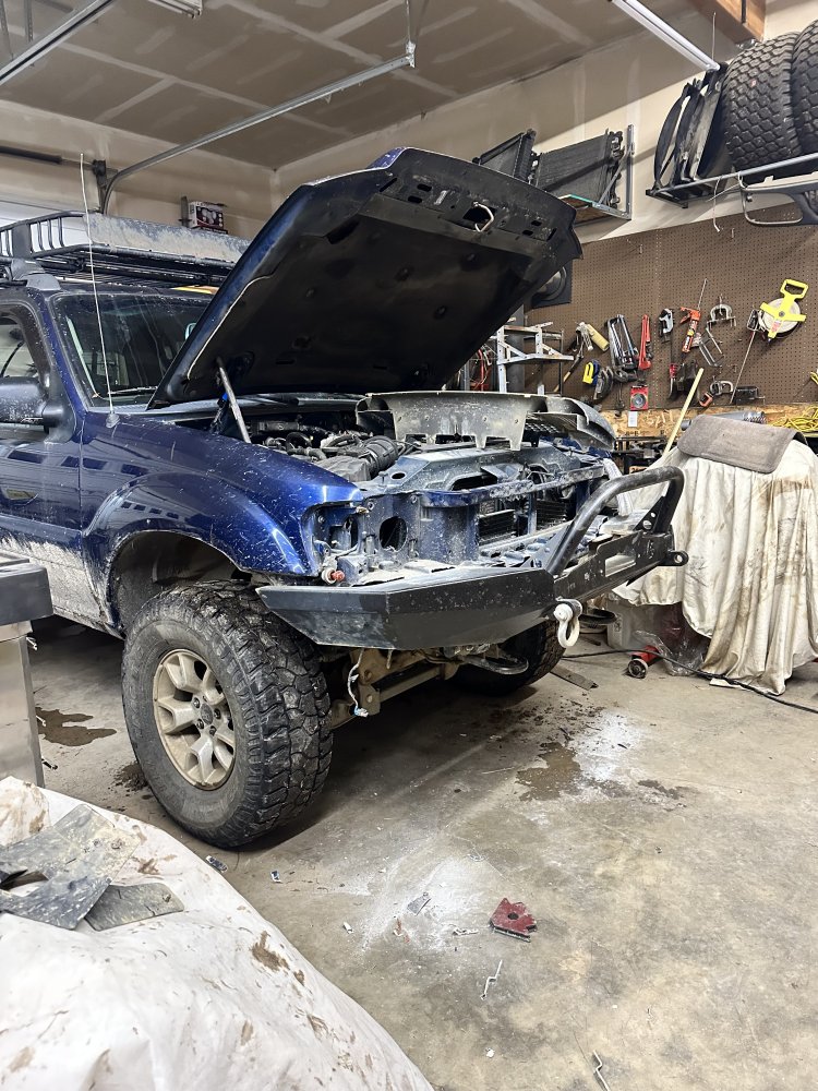

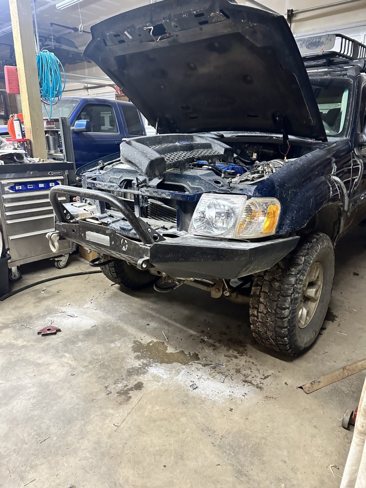

Finally got around to getting the bumper on. Had to hack it up a little bit as far as the header panel and the grille and a few other things since this isn’t a sport trac bumper lol but I think it’s coming out good so far.

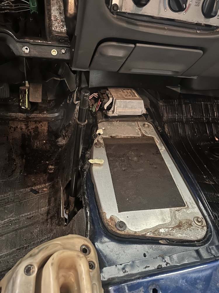

Hey you don't have an auto tunnel cover do you? I don't know where mine is and I have a manual one but hole isn't in the right place for the M5R2 and I don't know what I did with the spares I had. They are MIA.
Looks good man!
As a matter of fact I do…. I have a few.
Got the grille chopped up and everything is final for the bumper. Got the radio working and a few other things…. Gonna have to do a transmission here soon unfortunately…. She has a hard time going from 2nd gear to 3rd gear…. It does but it has to hit 40 mph and almost 3000 rpm with the OD light off … might try a new valve body and solenoids first but I do happen to have another v8 explorer I can take the tranny from…. See how this goes I guess
