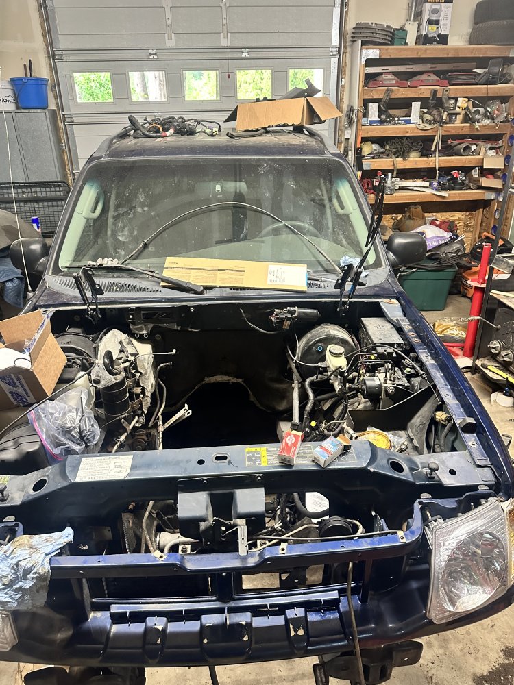

Found my wife a new truck!

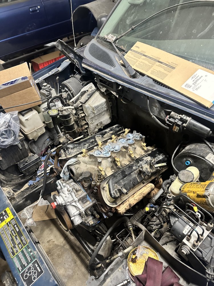

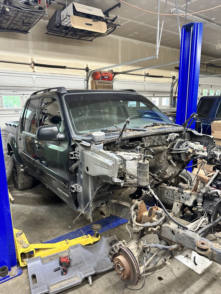

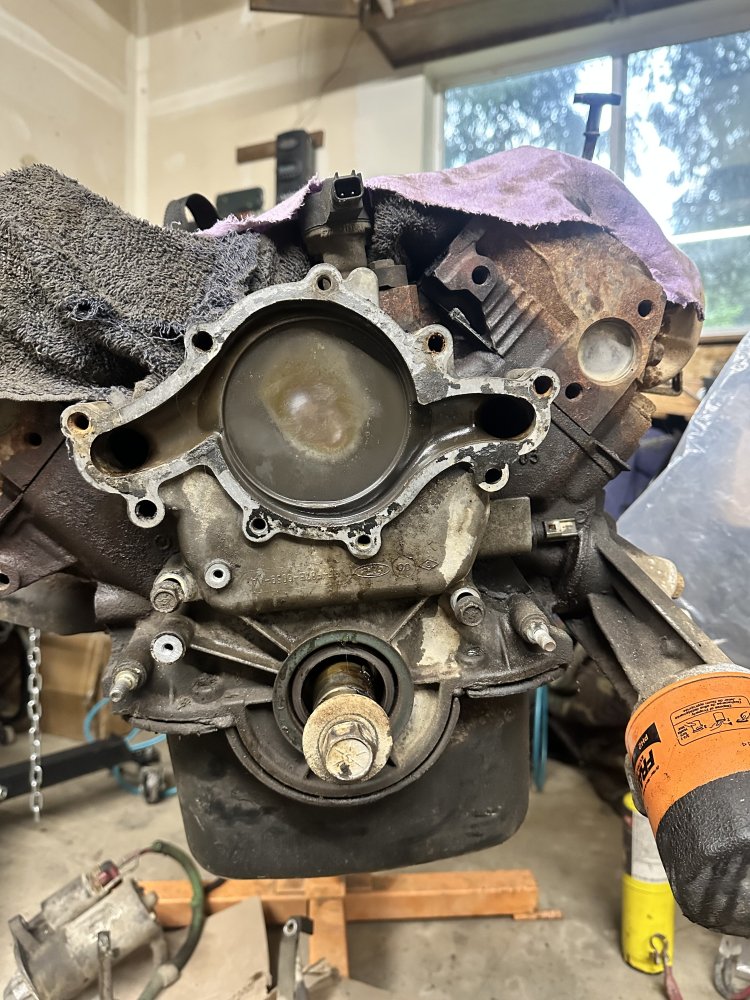

I know it’s been a while on this thread, but I got the drivetrain out and I am currently in the process of pulling the 5.0 apart to re seal it.
Anyone that knows these 5.0’s knows what I am saying when I say “THESE BOLTS SUCK!”
The 4 bolts to the left and right of the water pump and the R/Flower intake bolt… all 5 of them snapped and it took me 4.5 hours to get them extracted, but I was successful on all 5.
The oxy acetylene torch was my best friend for the whole process.

Yeah, it sure would have been nice if they had put a gasket on the waterpump that actually kept the coolant out of those bolts!

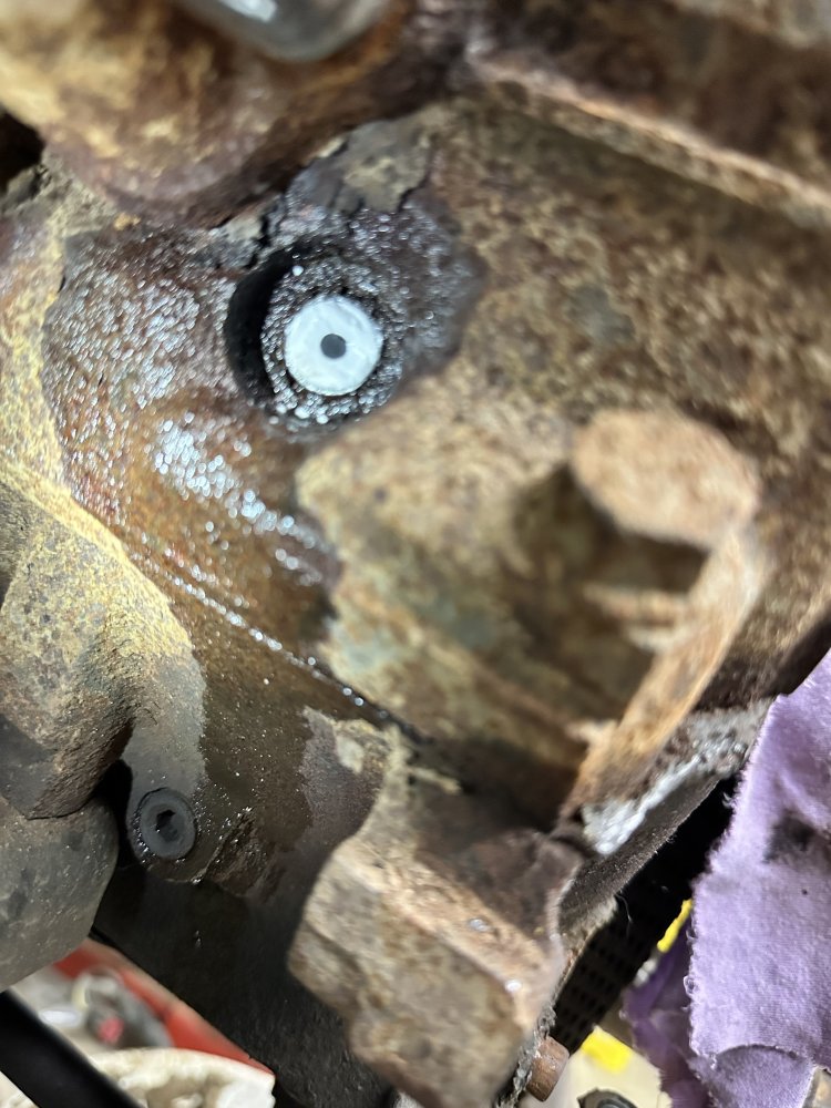

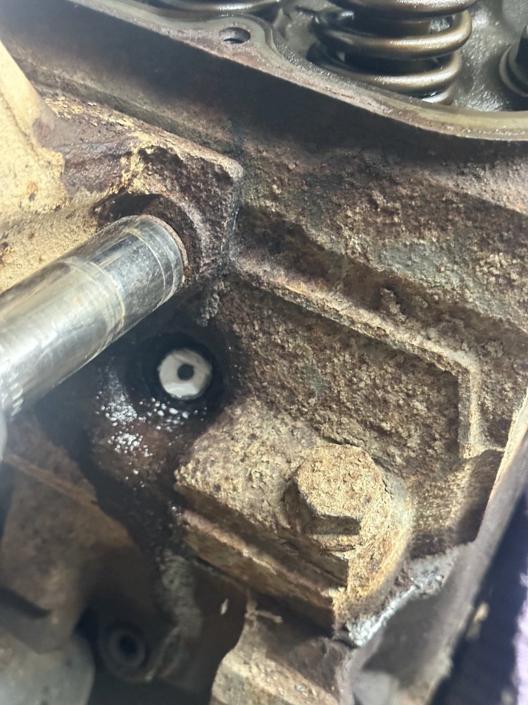

And the journey continues with stuff getting stuck! When pulling the spark plugs, one of them decided to break off in the head! Any ideas on extracting this ?

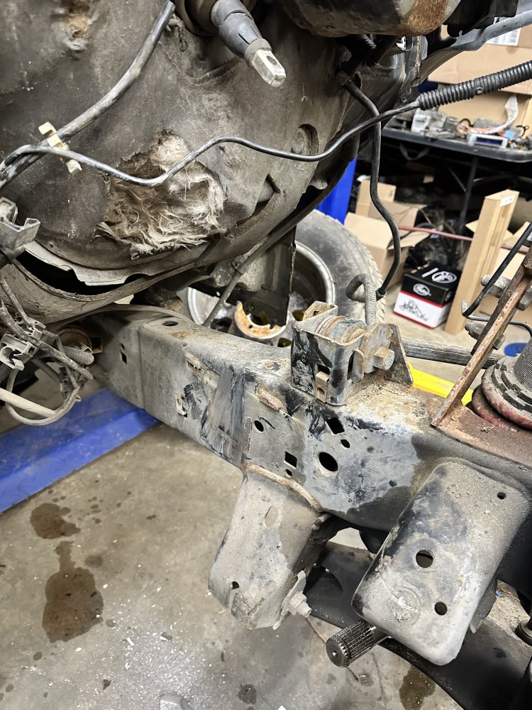

I don’t know if anyone has done this, but I think I have a solution.

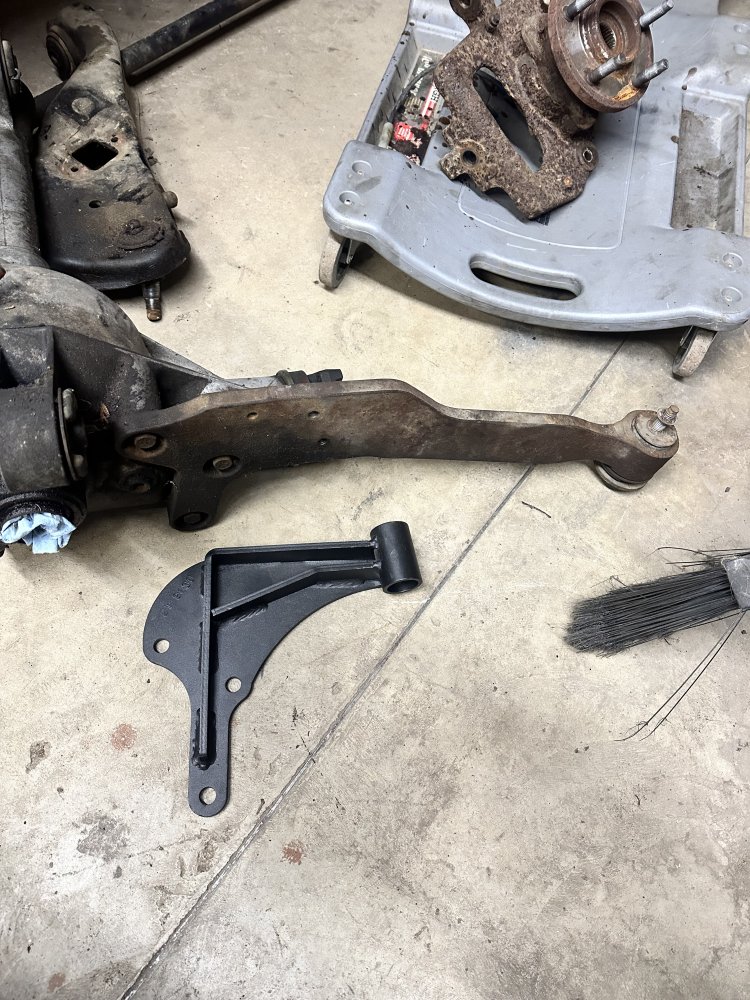

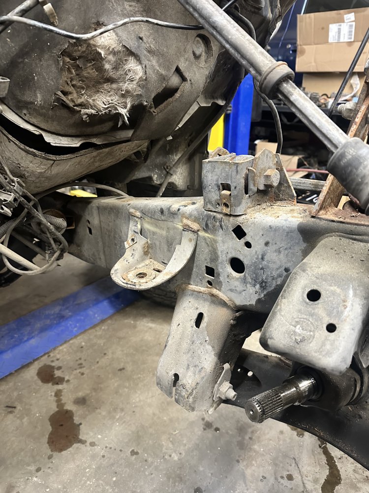

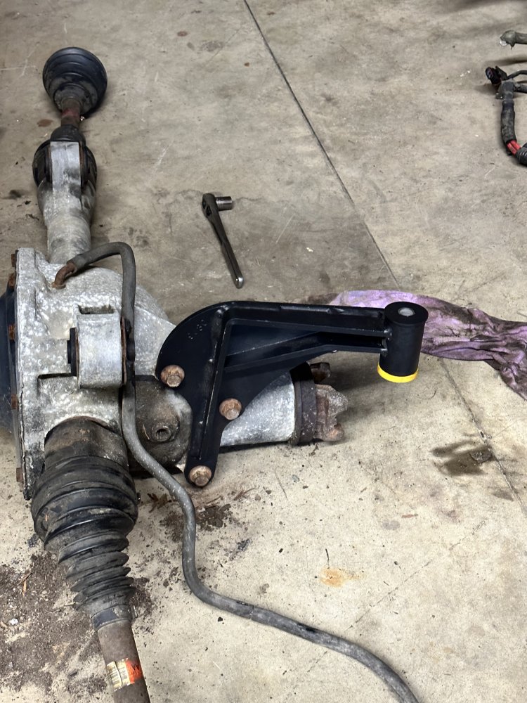

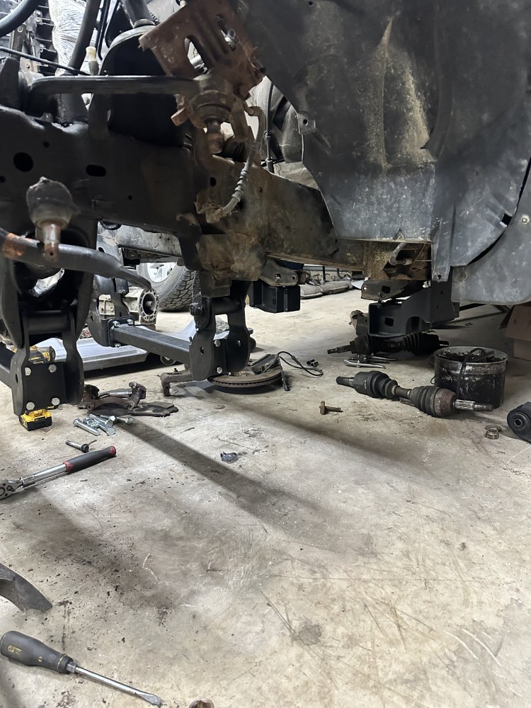

Has anyone ever put a super lift on a sport trac?I know the rear needs a spring over conversion and that’s not a huge deal… I need help with the front differential bracket… specifically the one that had the long “arm” that bolts on about a foot down the frame. Does anyone know if super lift has a part for this? Or do I have to cut and weld?

As with everyone else I’m trying to use all my free time to work on my wife’s truck and my sons bronco lol spreading myself thin.

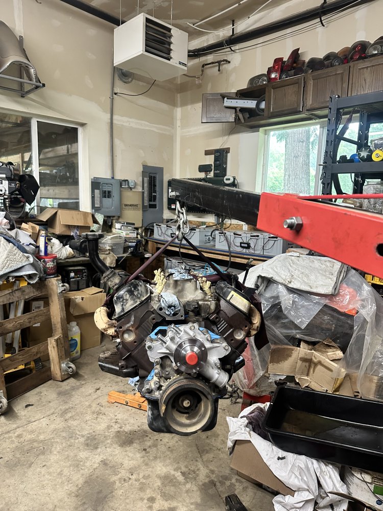

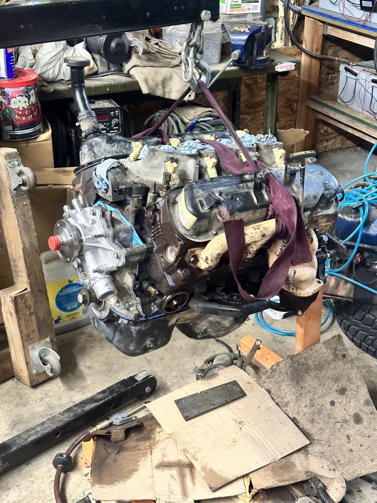

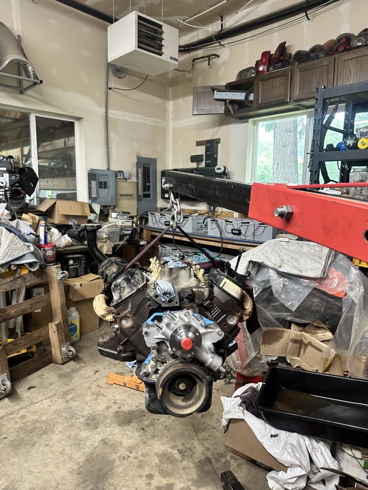

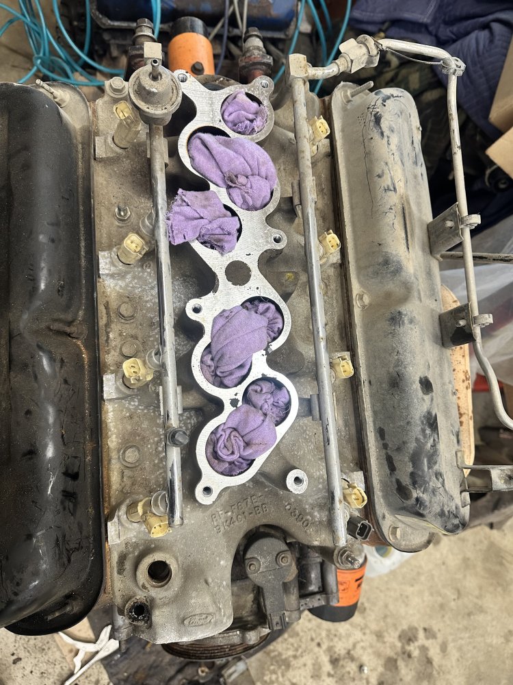

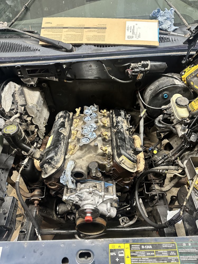

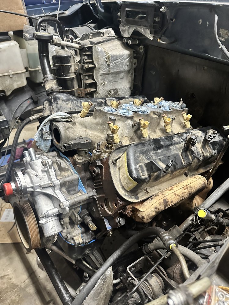

I installed the exhaust manifolds (cast) and did

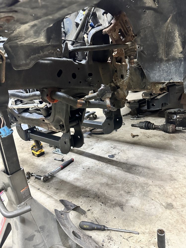

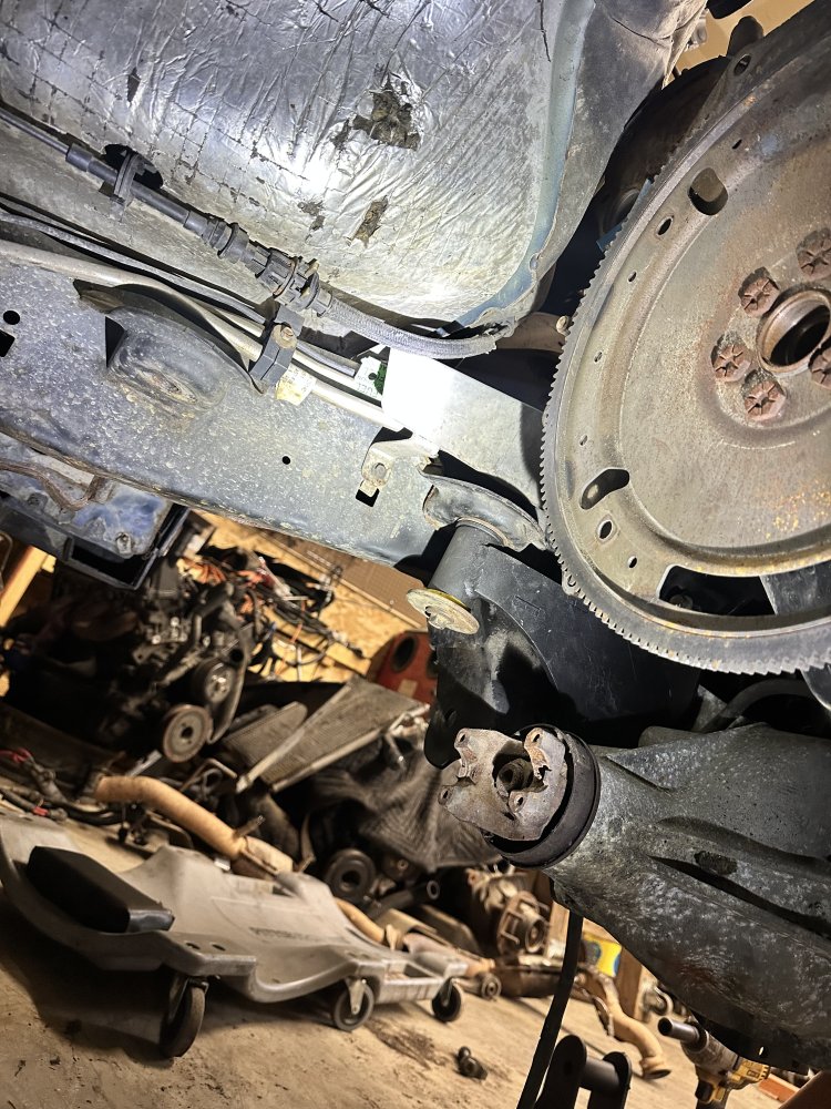

O-rings on the injectors and a few other odds and end things before planting the engine. I have before and after pics! Had to move the factory power steering cooler out of the way since the oil pan would hit once the transmission was installed. As far as the drop bracket for the front differential, we are probably going to cut the rear diff mount from the frame of another truck and weld it on to mine and use the super lift drop bracket as it was intended for a ranger instead. Not there yet, but we are getting there!

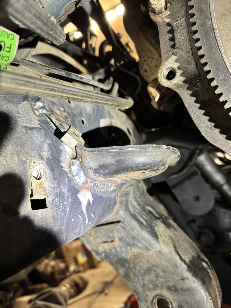

Cut a mount off one sport trac that is a parts donor and welded it onto the 05 since this lift is for a ranger we had to modify things slightly. Gonna have to do a spring over in the rear, but that’s gonna happen when we get the perches.

If you haven't ordered perches yet, receiver tube is pretty available anymore and makes really nice perches with a hole saw for the tube diameter...
Unfortunately I already got perches, but hey they were only $40 shipped so I can’t complain all that much. Super stout perches from Barnes 4x4 …. Same perched from ruff stuff but $20 cheaper

Got the transmission stabbed and torque converter nuts on and torqued.
Also, the driver side control arm needed to be replaced so I went ahead and did that too.
