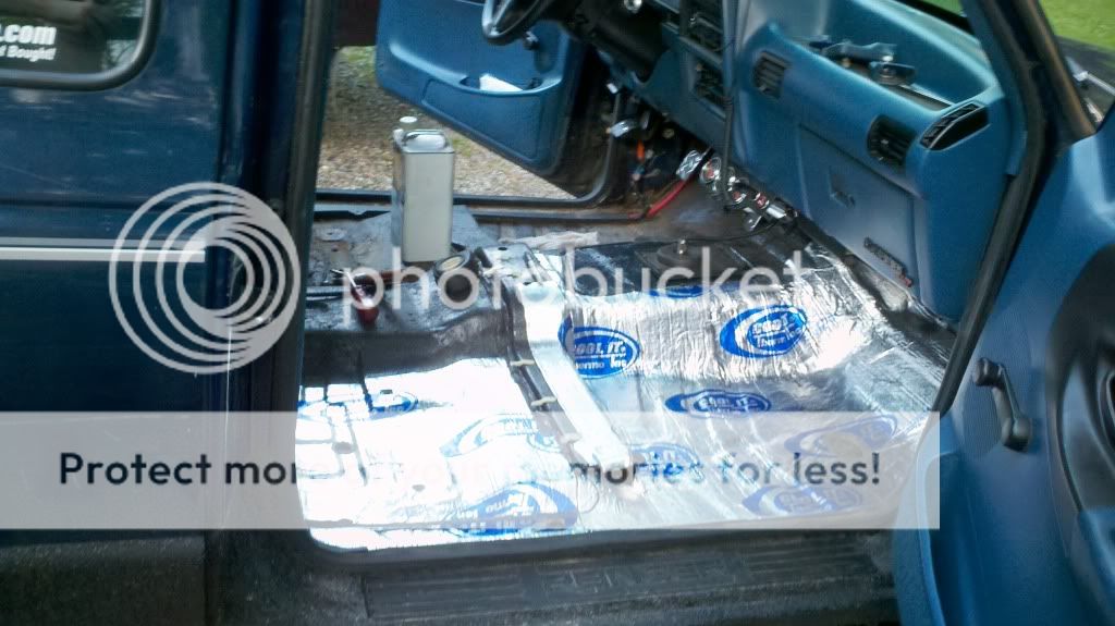

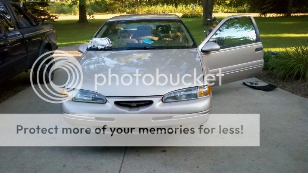

its been a few days since my last post but ive made more progress on the t-bird this week, i got the header panel changed out (after getting a cracked replacement one the first time), installed a new tensioner pulley (after getting a bad bearing in the first one i picked up), and i installed a kenwood CD player in it (after buying the wrong connector the first time, needed one for the premium sound). i brought home a headlight cleaning kit and let Terra work on her lights while i stripped out the interior of my ranger and installed some sound deadening on the floor (they must have marked the packages wrong because i got an extra 18" in the first roll).
by an act of pure luck i ended up using the longer roll on the passenger side, where the exhaust runs, and then used the second roll which was shorter on the passenger side. i also added a new self-adhesive heat shield to the bottom of the passenger side floor pan because i must not have cleaned the floor pan well enough when i installed the first one and it started falling off.

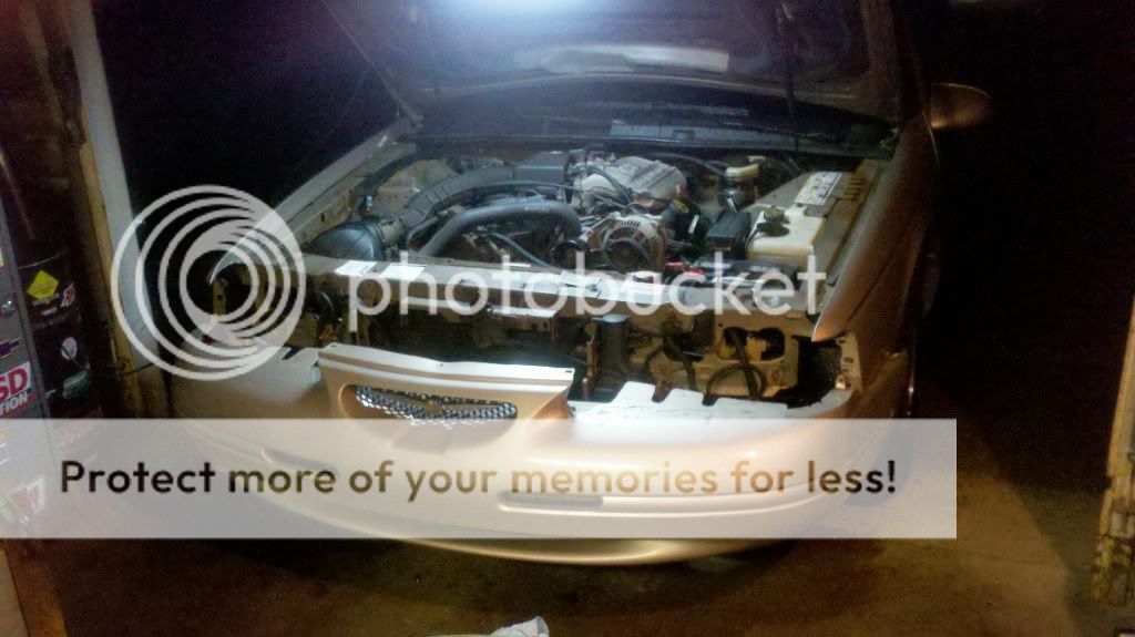

i didnt take any pics of the interior of the bird while i was doing it and i appologize, but since the bird didnt want to come out of park when you depressed the thumb button on the shifter, i decided to tear apart the center console and see what i could see. after 3 hours of cleaning spilled coffee and what im guessing was pot resin off from the shifter assembly and surrounding cables and components i was able to lubricate and reassemble everything and now it shifts like a dream. as much as i hate to say it on here, this T-bird has been more fun for me that her sport trac ever was.

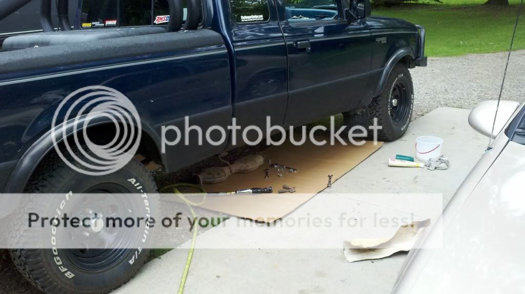

last night my buddy with the caprice stopped by and said his car was making a clunking noise so i got under it and looked around. what i found was a pair of missing sway bar bushing bolts, which allowed his bushing brackets to bent open and the sway bar dropped down. 20 mins with a hammer and some pliers and i had him back in business. apparently when he took his car to the wheel shop to buy the adapters and have them install the wheels they told him that the kit i put on his car was no good, so they chraged him $700 to put the "correct" kit on it, which consisted of removing the new lift springs and doetsch extended shocks and then going to O'reallys and buying stock coil springs and cheap ass gabriel shocks and then putting the twist in spring boosters to achieve the taller ride height. they kept all of his old stuff (which he payed $1500 for) and told him that it all got destroyed when they removed it. i know one of that blackfricans is riding around on his nice kit with an extra $500 in his pocket from ripping my friend off, but thats what you get when you deal with Niggaz. I think it sucks because thats the whole reason i offered to lift it for him, so he wouldnt have to deal with that kind of shit, but hes happy and doesnt know any better so what ever.

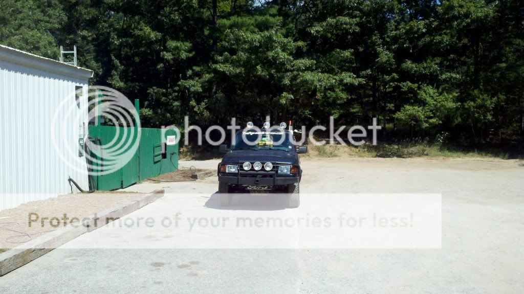

a pic of some ranger ass, i got to look at that ass for the whole trip!

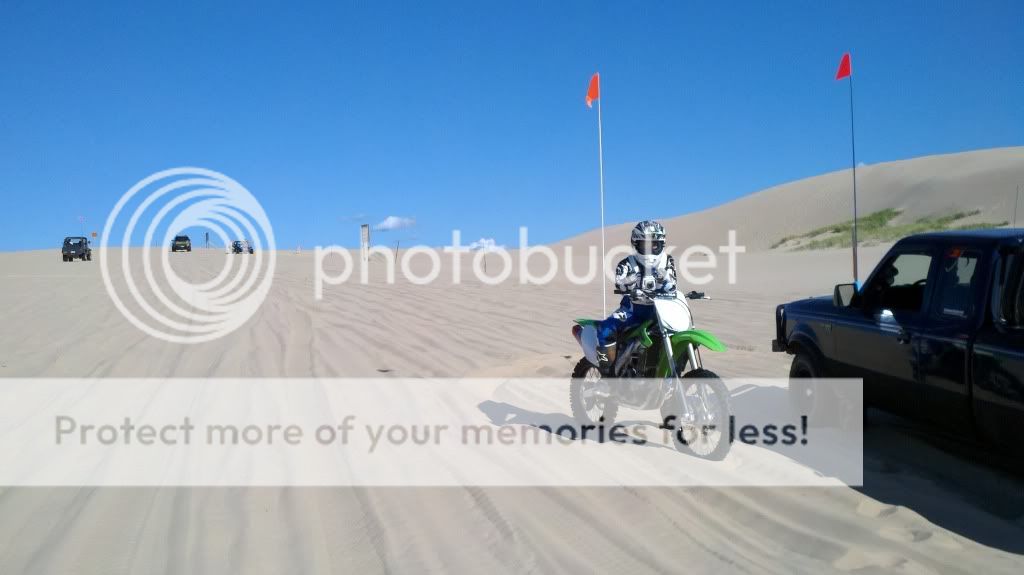

after i got geared up and rejoined my friends who were already riding around

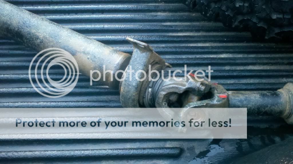

so my truck has been making a squeaking sound ever since i got home and unloaded all the gear, it was probably making the noise the whole time after leaving the dunes but with all the camping gear rattling around i didnt hear it. i thought it sounded like broken brake hardware and my fluid level in the resevoir had gone down a bit so i brought home a hardware kit and popped off the drums, expecting to find a broken spring or something out of place. i ended up finding a cracked brake line adapter (the one that goes from 1/4" to 3/16 at the wheel cylinder), which led to a "broke off flush in the wheel cylinder" condition, so now i need a new adapter and wheel cylinder. i decided i would grease all the u-joints and steering parts as well since i still hadnt found the source of my noise. the rear joint took a fair amount of grease before it oozed out the seals, but when i moved on to the middle joint the source of my noise became aparent. this will be the 3rd carrier bearing ive had fail on me in 30k miles, thats bullshit!
im thinking its time to start looking for a 1-piece shaft
