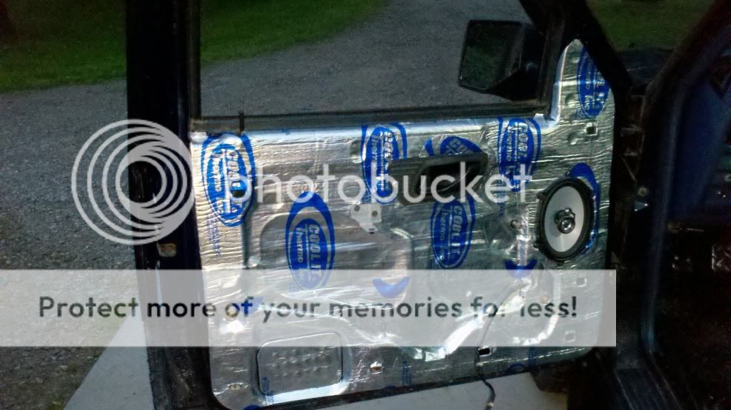

after doing some research (emphasis on some) ive decided to sound deaden thumper in and effort to reduce the rattles. the sound system sound great when all the windows are closed, but once you roll them down and pop open the slider there is much to be desired. so after pricing out various brands and asking some people about what they used and their experience with it ive decided to go with Themo-Tec's "the suppressor" and i also picked up some 3M pads to put on the outer door skins.

i got the doors done last night, I started off with the 3m pads on the outer skins, then lubed the window crank assembly with white lithium paste and an acid brush, then i applied the suppressor mat and tried to keep trac of the important holes.

it was dark by the time i started the passenger side door but it went smoothly and it was actually faster than the drivers side door that i did in the day light. im going to try to do the rear of the cab tonight, just have to do some more searching and see if i can find out how other people have placed the matting around the jump seats and rear speakers. i also want to put a few pieces on the inside of my center console and my cup holder to keep the vibrations down.

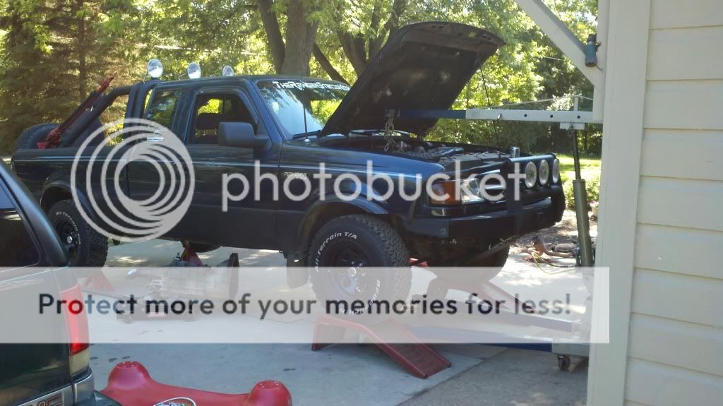

i finally had to change the slave cylinder in thumper, its been leaking since january but not so bad that i couldnt just fill it up a little and keep driving. it finally gave out on the first day of my 4 day weekend.

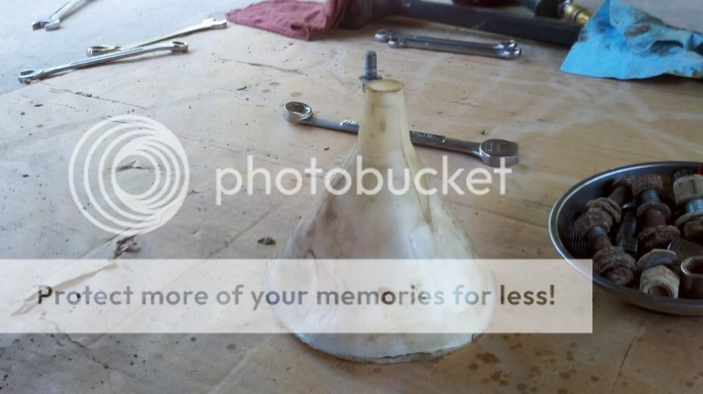

during the tear down to get the trans out i realized how nasty my starter was getting so i custom molded a funnel in hopes that future oil changes wont be so messy.
