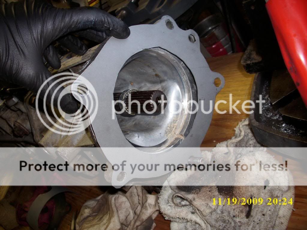

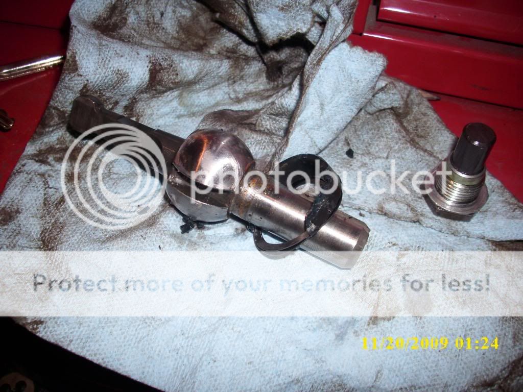

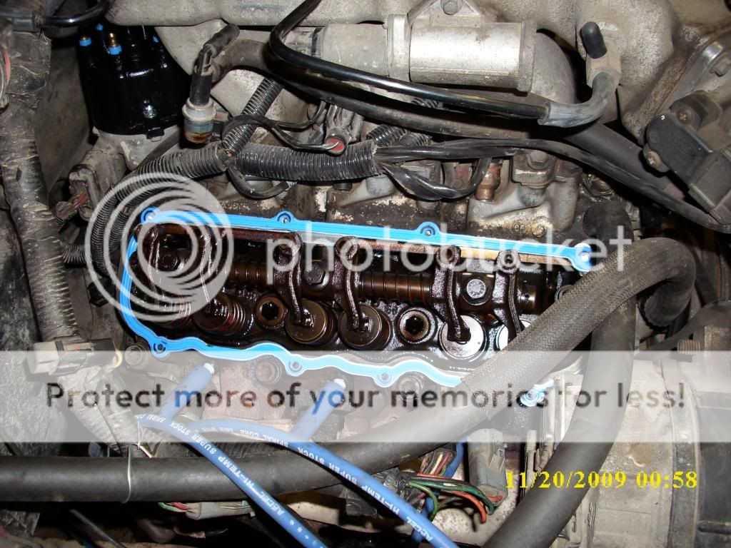

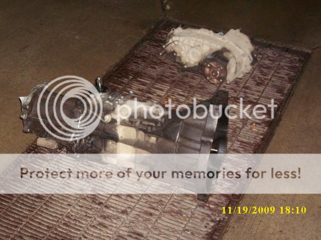

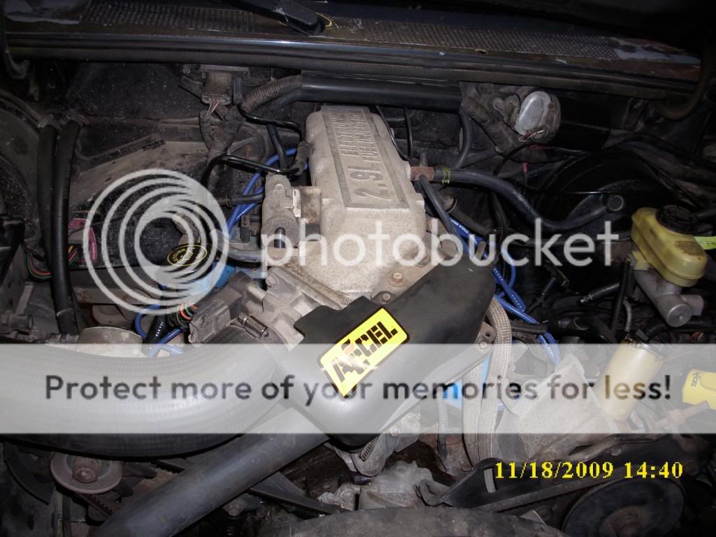

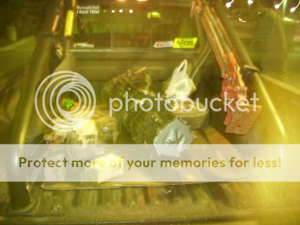

i have been workign on my brothers truck for the last 2 days and its finally done (all except the shifter bushings that we have to wait on ford to get). heres the pictures i took, its definatley going to feel like a different truck once its back on the road again!
i put the oxygen sensor in on my lunch break and i also got his catalytic converter in place with the new gaskets and hardware and i just have to go home tonight and double check that everythings tight and then we can throw the interior back together and fill up the fluids!

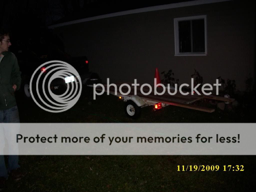

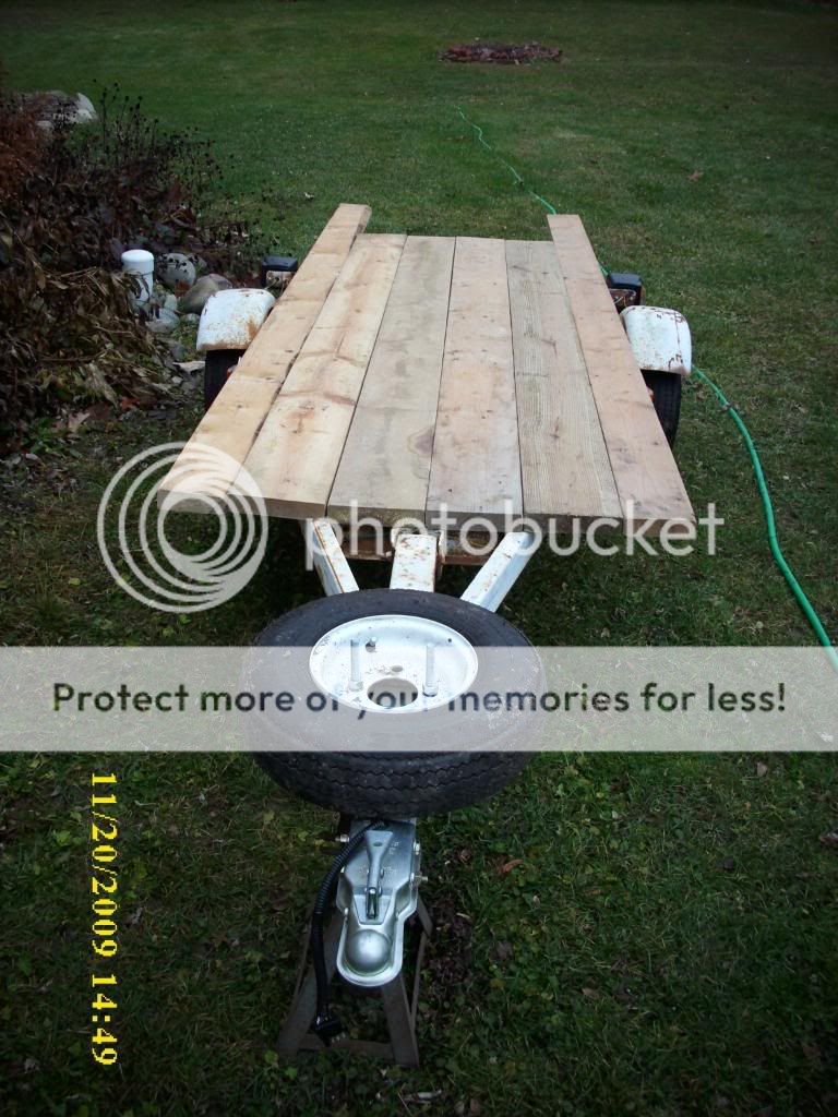

i got the trailer into the last stages of mock up before i weld on some more supports and paint it. i still need to cut the boards to the same length and drill the holes to mount them, but its getting there quickly.

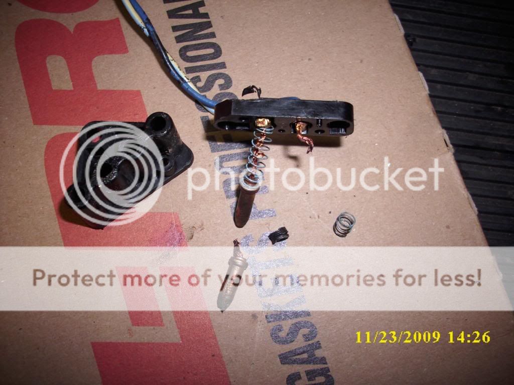

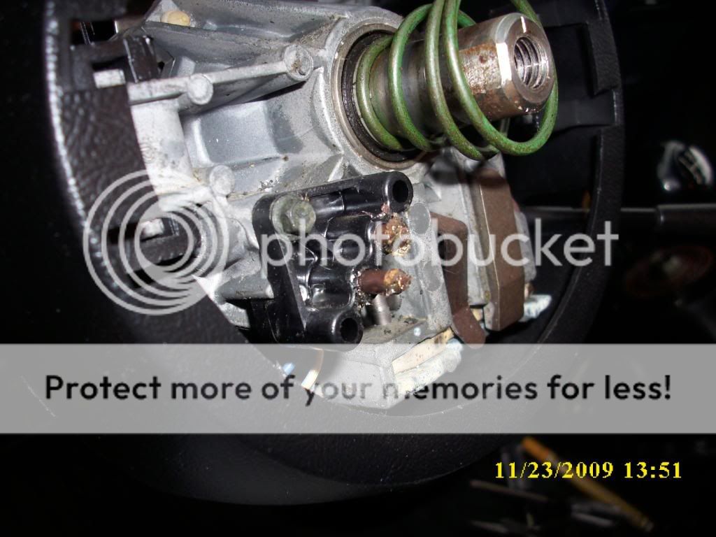

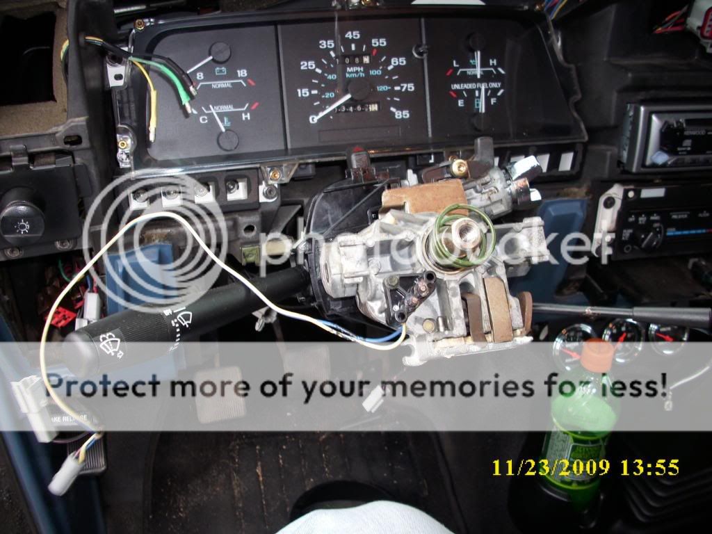

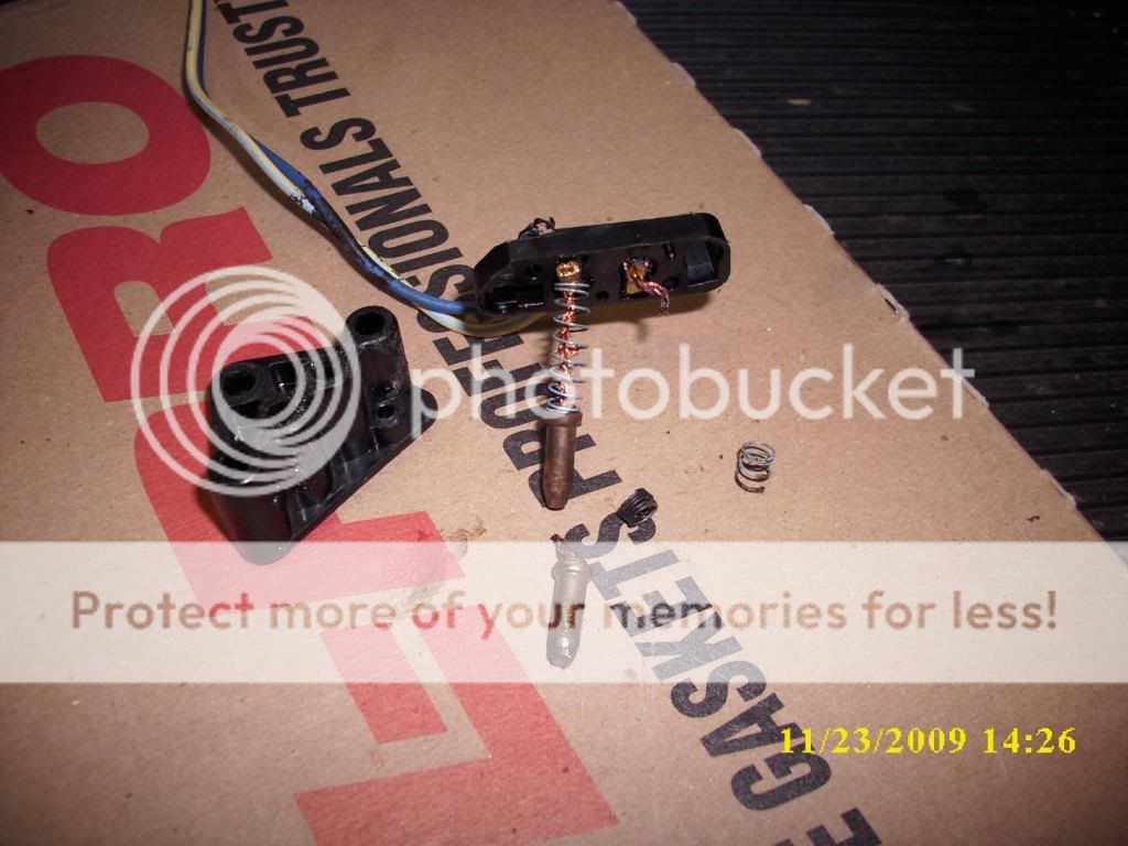

on my last couple of days off i got my horn fixed (it was a burned contact just like i thought), i got my back up lights hooked up to the toggle switch, and i built a little box to hold sand bags for the winter.

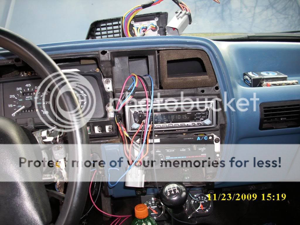

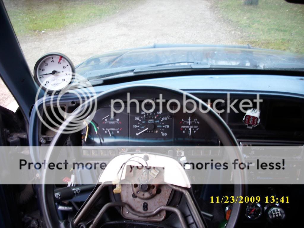

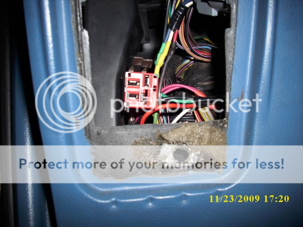

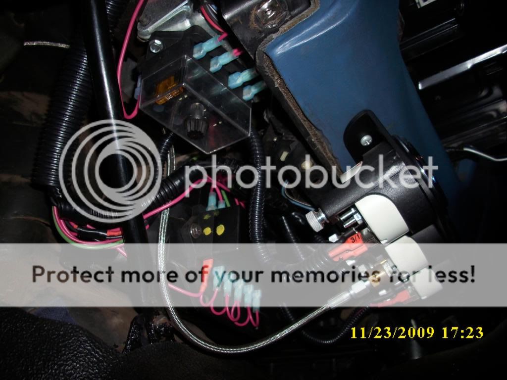

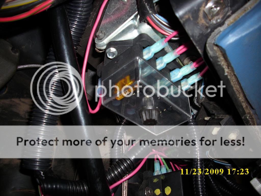

when i was fastening the fuse block to the underside of the dash i accidentally misjudged the length of the screw i was using and ran it into a black box that said something about brakes. now my abs light has been intermittently coming on and im pretty sure i was the cause. good thing i have a parts truck!
i also decided to probe the contacts on the fog light plug to see if i could make sense of how things were wired and im close, but i wish i could just get a wiring diagram of the fog light circuit to confirm my thinking.

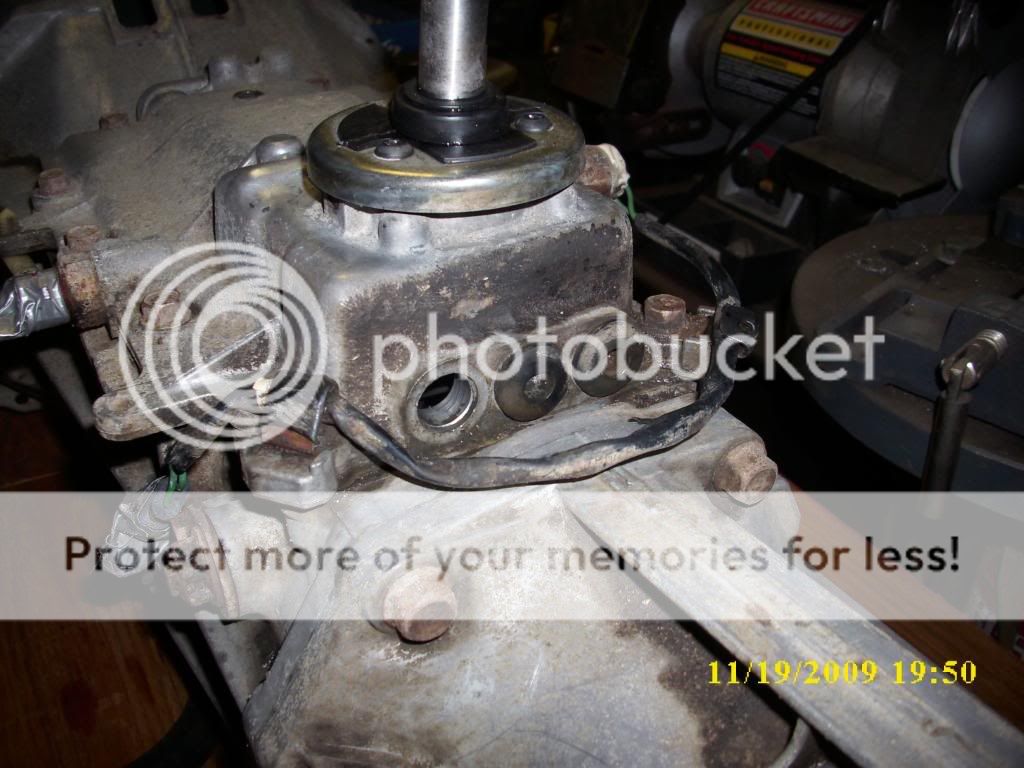

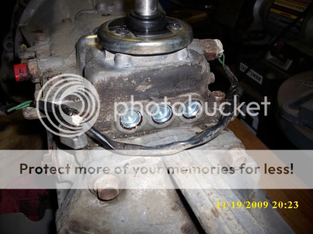

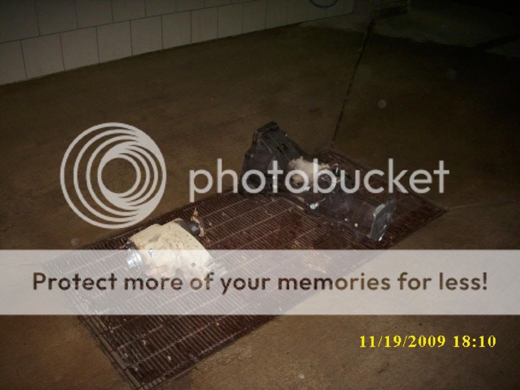

Hey ForOffRoadDriving,

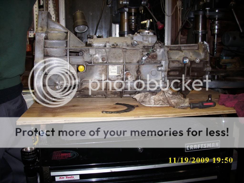

What did you put on the dorman plugs when you installed them on the transmission. It looks like there's some kind of sealant. Thanks in advance.
Adreenaleen
Hey nice shooting, what size lift and size tires are those???
thumper has got skyjacker leveling coils with 1/2 skyjacker coil spring spacers and im currently running 30x9.50x15 mud terrains on 15" cragar soft 8s. to answer Adreenaleens' question i used permatex aviation form a gasket liquid sealer. we use it in our machine shop when we install freeze plugs to ensure that they seal because with all of these grass-hut-nation parts floating around the last thing we need is a customer coming back for a leaking freeze plug.

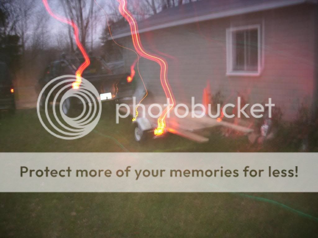

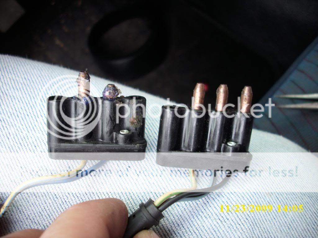

Happy black friday.........my f**king truck broke! i went out side this morning to head to work from terras house and as usual i let it warm up for a few minutes when all of a sudden it just quit. no spitting or sputtering or any sign of trouble, just dead. i gave my truck a funny look and turned the key and it fired up again, but was running a little rough, so i gave it some gas and things smoothed out. i then put it in gear and got rolling through the trailer park and then again out of no where it just died. i tried to restart it but it wouldnt fire, so i turned the key back off then put the pedal all the way to the floor incase it was doing its 'cold start- over fueling thing' that is usually does, but it still wouldnt fire. i got out and pulled the ECU relay and then put it back in, tried to restart it and still nothing. it didnt throw a check engine light and i couldnt get any codes when i tried to pull them once i got it home. i called up karl and told him to come rescue me, so after about 30 mins we were hooked up and on our way home. i did snap a couple of pics for you guys, since i know how much you crave them!
so now i have to go home tonight and try to figure this thing out, it should be something simple (i think) since it was just an all of a sudden thing, but its just got me so worked up that im afraid ill be too blinded by anger to catch it right away. i guess the broght side is that i didnt wake up hung over, which is amazing since i drank alot of makers mark and dr. pepper!
