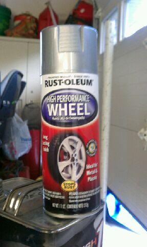

So I bought some factory ford ranger fx4 alcoa rims from a guy off craigslist for a pretty sweet deal (imo). The only thing about them is that he primed them with a self etching primer and then painted over it with a can of rustoleum :annoyed:. I would like to get them back to their original finish but dont know how to! I was thinking maybe sand blasting but I heard that it can warp the wheel. I also thought about using chemical but I also heard that some kinds can damage the wheel as well.
Can somebody point me in a general direction!

Those wheels as supplied form Ford have a smooth machined surface with a clear coat. Sand blasting them should not warp the wheel because the metal is too thick but it will leave a rough surface. I think using a stripper that is safe for aluminum would be the best way to go. You will probably still have to polish the wheels to get them looking good before applying a clear coat but it should be much easier than polishing after sand blasting.
You get get them bead blasted, OR, you can soda blast them yourself.
If you have an air compressor, this is easily achievable and you only spend $7 of baking soda.
But, try minor chemicals first. Let us know how it goes...
I think I'm gonna try some of the chemicals first. But if the light stuff doesn't work then I'll have to figure out how to soda blast them, but idk if my air compressor is large enough. And I'll definitely post some pics with the finished result!
