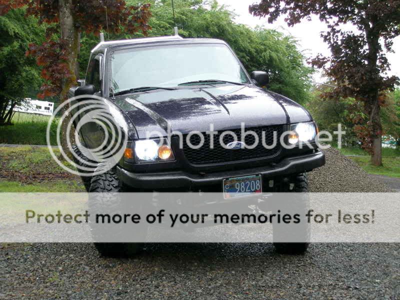

It's real neato seeing one LCA drooped down and thet other LCA stuffed...

well i'll need to keep mine on. I love to take corners fast:thefinger: Dude that pic looks sick!
