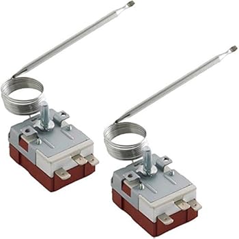

The control I use is the cheap one at the store, it works good, and has been working for the past 5 years. It's one of these
I wire it directly to the battery. Then through the switch and then to the fan. The only problem is the temp probe. They want you to slip it up into the upper large radiator hose, and run the small wire out and clamp around it. It's very difficult to keep this from leaking. So I put this setup in one of the heater core hoses.

American Volt temp sensor (thermostat) in the LOWER rad hose.
I've been through all of the rest of them, all have failed in one way or another. American volt thus far is as close to indestructible as I can find, and may not need a relay depending on power draw from the fan.
