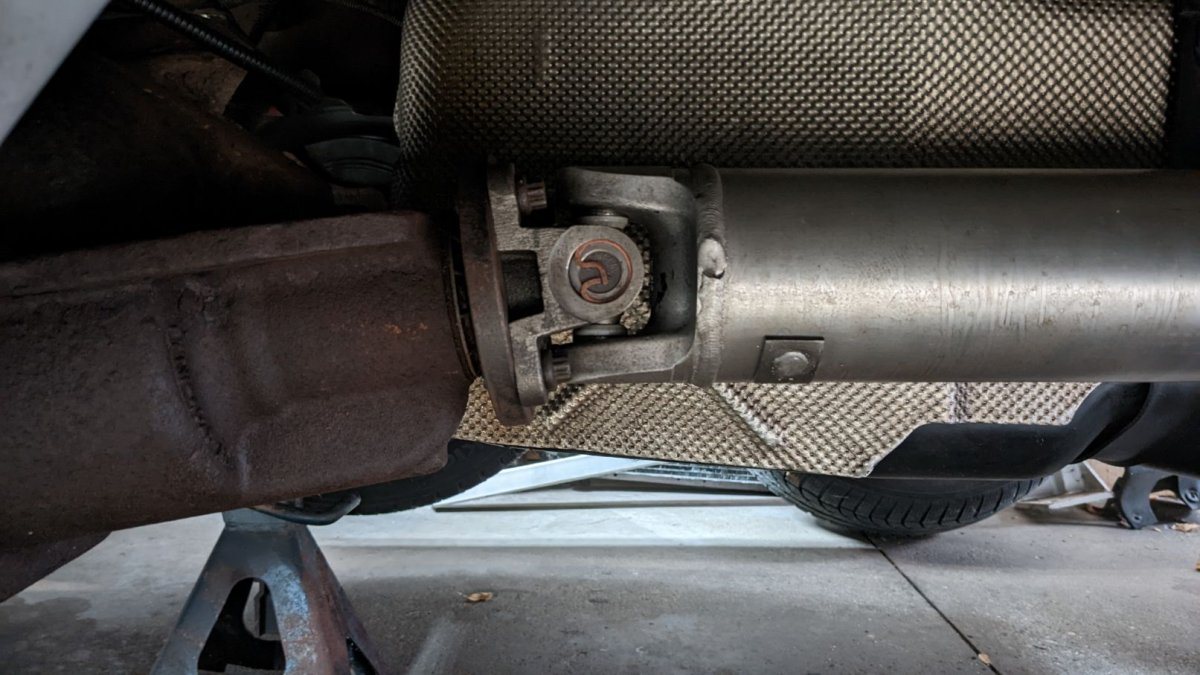

I’ve got a 6 degree shim in now and the pinion angle is still 4 degrees up. It would require too much Additional shimming to get it right.
You hadn't mentioned that, but it sounds like you probably made thhe right call. It's got me curious how you've got your rear suspension set up for the Explorer axle's pinion angle to be 10 degrees off.
mine was absolutely abhorrent, keeping it spring under on my Ranger.
stock suspension other than the spring under explorer swap.
