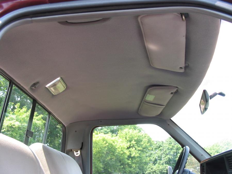

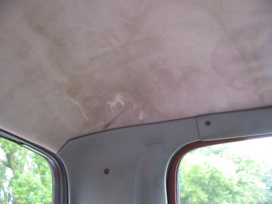

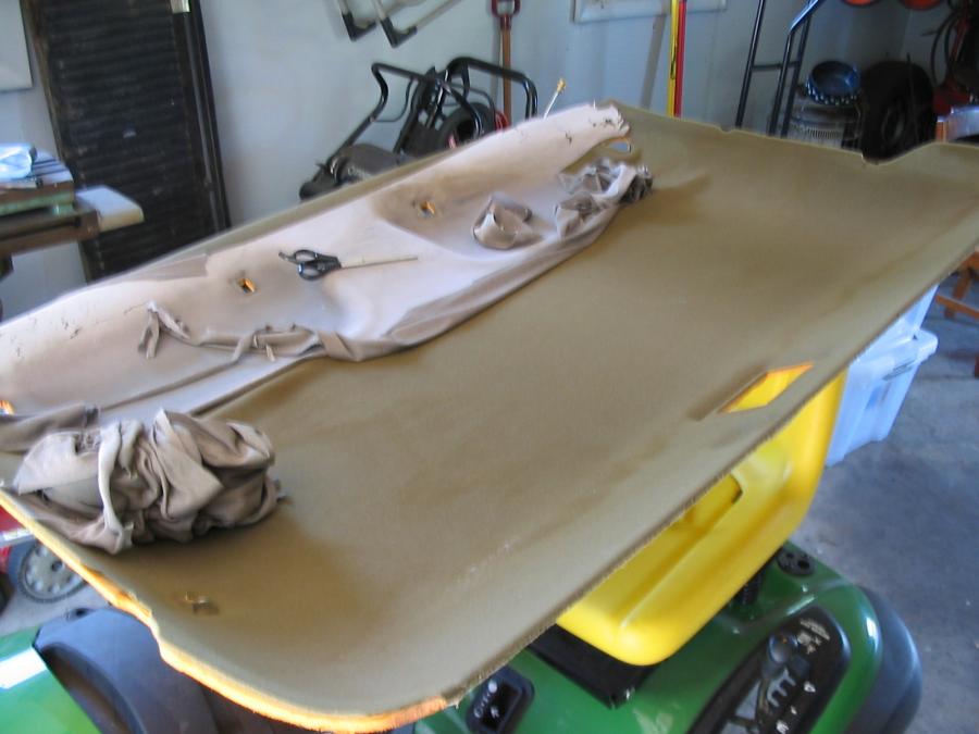

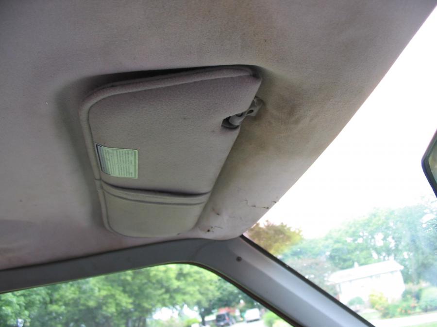

Mr headliner had dry rotted away, so I pulled it down and replaced it. When I stripped off the fabric the foam was in perfect shape and only the thin fabric came off. So I sprayed both the new foam backed fabric and old foam/shell heavily with headliner material and left it set for 24 hours before reinstalling. It looks great; I'll let you know how it holds up over time.
