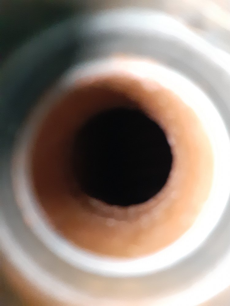

Ok so I know I am not a mechanic, so I really need some input.
1. I am replacing the thermastat as well as a precaution, when I went to drain the antifreeze, it's red like it's rusty. When I took the old thermastat off, it looks like rust in the engine. Can that be clean/flushed out?
2. I have been doing research on where the ECT Sensor is, and I am not having any luck. I've seen videos of 95, 02-11 Rangers with the 4.0 SOHC, but the engine doesn't look anything like the 4.0 EFI in this 2000.. I don't think the 4.0 EFI was a special engine or something so does anyone have a picture or can explain where the ECT sensor is?
3. I thought the ECT Sensor was on the engine block above the thermastat next to the alternator, but apparently Advance Auto told me that is the ECS (Engine Coolant Switch), and it's cover in the rust particles (I guess that's the best way to describe it).
You can barely see it, but under the connector is the spot that the Engine Coolant Switch goes, and apparently the Coolant Switch and Coolant Sensor are 2 different things.
So I replaced the Thermostat, ECT, and ECS.
I also replaced the battery, It's pouring rain so I couldn't do the code scan, but the truck still doesn't want to turn over due to lack of air.
Is there anything else I can try? I even took the air intake off but the truck still not getting air.
