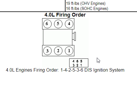

front ^^This is how the spark coil pack is plugged. FYI: Distributor is a term used for older styled systems.
Your passenger side (right side, No. America) wires for cylinders 1,2 and 3 are correct.
It is only a coincidence that graphic representations of the cylinder numbers 1,2 and 3, and the coil location numbers 1,2 and 3, match.
Your driver's side (left side No. America) is incorrect. You plugged the wires into the wrong holes in the spark coil.
The CYLINDER numbers are 4,5 and 6 going front (radiator) to rear (firewall).
The SPARK COIL numbers do not match the CYLINDER numbers.
Cylinder #6 is the driver side closest to firewall. It's wire goes to the COIL SOCKET adjacent to #2.
Cylinder #5 is the driver side in the middle. It's wire goes to the COIL SOCKET adjacent to #1.
Cylinder #4 is the driver river side closest to radiator. It's wire goes to the COIL SOCKET adjacent to #3.
Go here for a short video:
You're not the first to make this mistake.

All the diagrams I saw showed it as the following as the order, and I actually ended up finding the diagram on this forum's Tech Library (https://www.therangerstation.com/tech_library/4_0_Page.shtml)
I also know that since I am not an auto mechanic by trade, I would have some difficulty understanding how to read this.
3 6
2 5
1 4
Below image is from https://www.therangerstation.com/tech_library/4_0_Page.shtml
