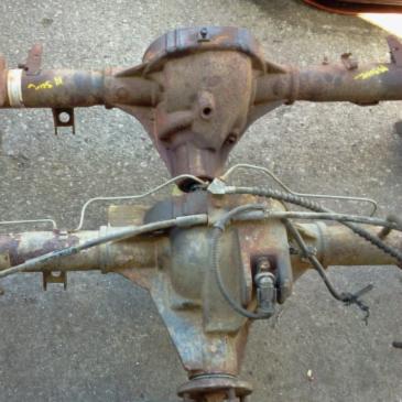

2008 Ranger // upgrading to 2010 rear axle/disc // master cyl available
Drum has single brake line
Disc Has Two
Where to Add a "T"
Flex lines from wheel to top of differential in place
Run single bigger diameter line to rear??
2010 master cyl
Has larger braided line // Run with 2008 ABS
T after abs unit. ??
Bypass abs for rear. ??

It will come down to: Does the differential housing still have the hole for the differential sensor; does the differential still have the tone right.
If the differential does - then it can be treated like a pre-'09 axle (the sensors at wheel end just won't be connected).
If the differential doesn't - OP will need to decide if he wants to drill the differential housing to install central sensor/pull differential to install tone ring.
Picture of top of the differential pumpkin would be work 1k words.
We've got a page for that.
It doesn't show inside the differential. Provisions for the sensor are not there, so the tone ring probably isn't there either.
