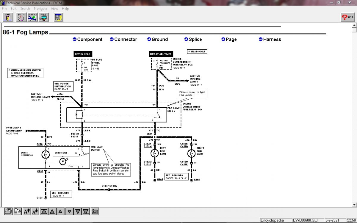

Have you wired your *new* foglamp switch according to the schematic?
The *solenoid* side of the relay will not energize unless that circuit grounds thru the foglamp switch.
One can see that the switch has a one way diode in the circuit as well to prevent current feedback to the switch from the battery side of the relay, when the relay closes all of the current flows to just the foglamps & not back to the switch.

I don't really understand why Ford produced the switch wiring in the manner they did......the switch is pressed to close the circuit that allows the *control* side of the relay to ground. When that happens the *battery* side of the relay closes to complete the circuit to light up the lamps. In my opinion there isn't a need for the 2ndary circuit that splices into the harness to the lamps from the switch (pin 6) to the splice S127. There is a voltage drop induced at the coil of the solenoid & a 2nd voltage drop at the dash lamp, & then the circuit goes to ground. To me the 2ndary to the lamps is redundant.
