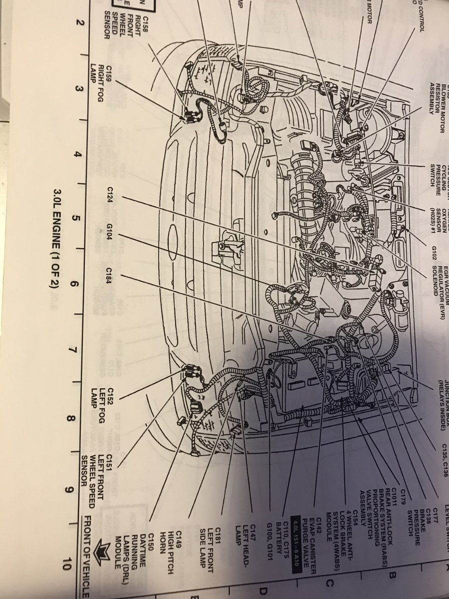

follow the wheel speed sensor cables, should find the fog lamp wires.
So I went to a local junk yard today to see some that have the wiring. Mine doesn't have it for some reason. This image is where the speed sensor line is. I got the wires off 1 of the Rangers at Pull-A-Part and am going to tie into my parking lights. Unless I can figure out how to make the factory switch active.

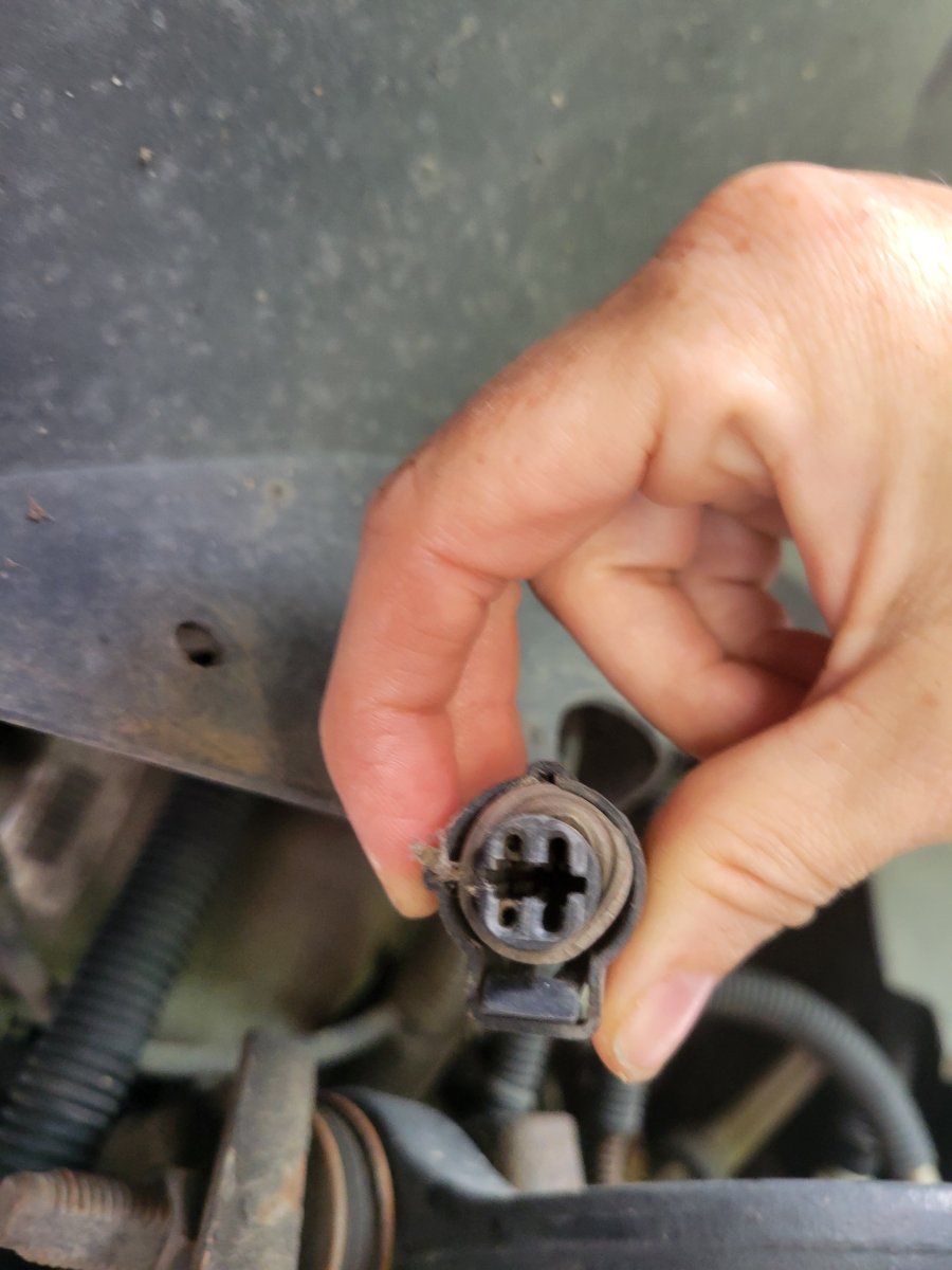

Also on my 01 XLT I have a round 4 prong plug not hooked to anything by chance do you know what it could go to
No, I don't, and I don't have any wiring schematics newer than 1994.
