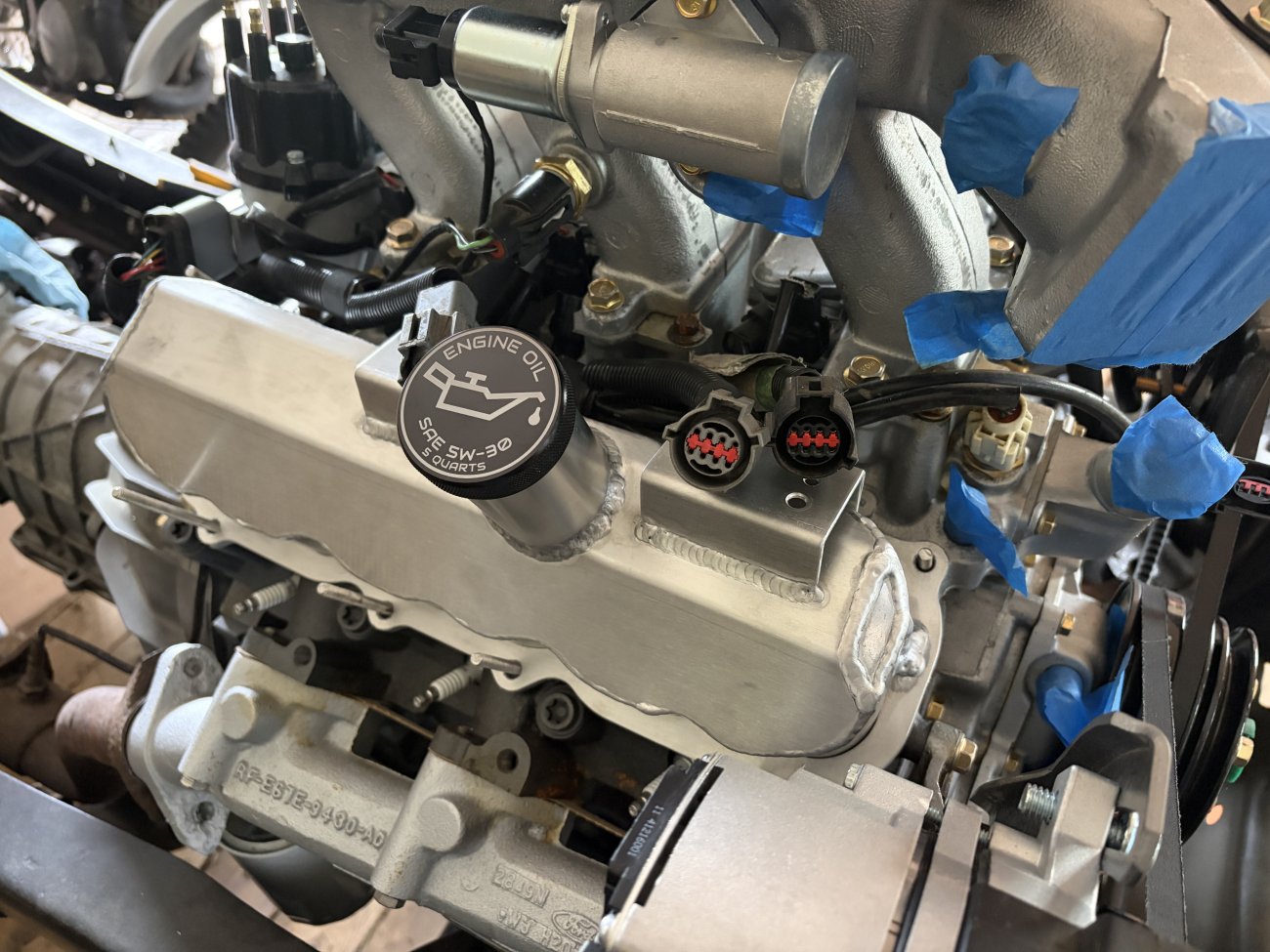

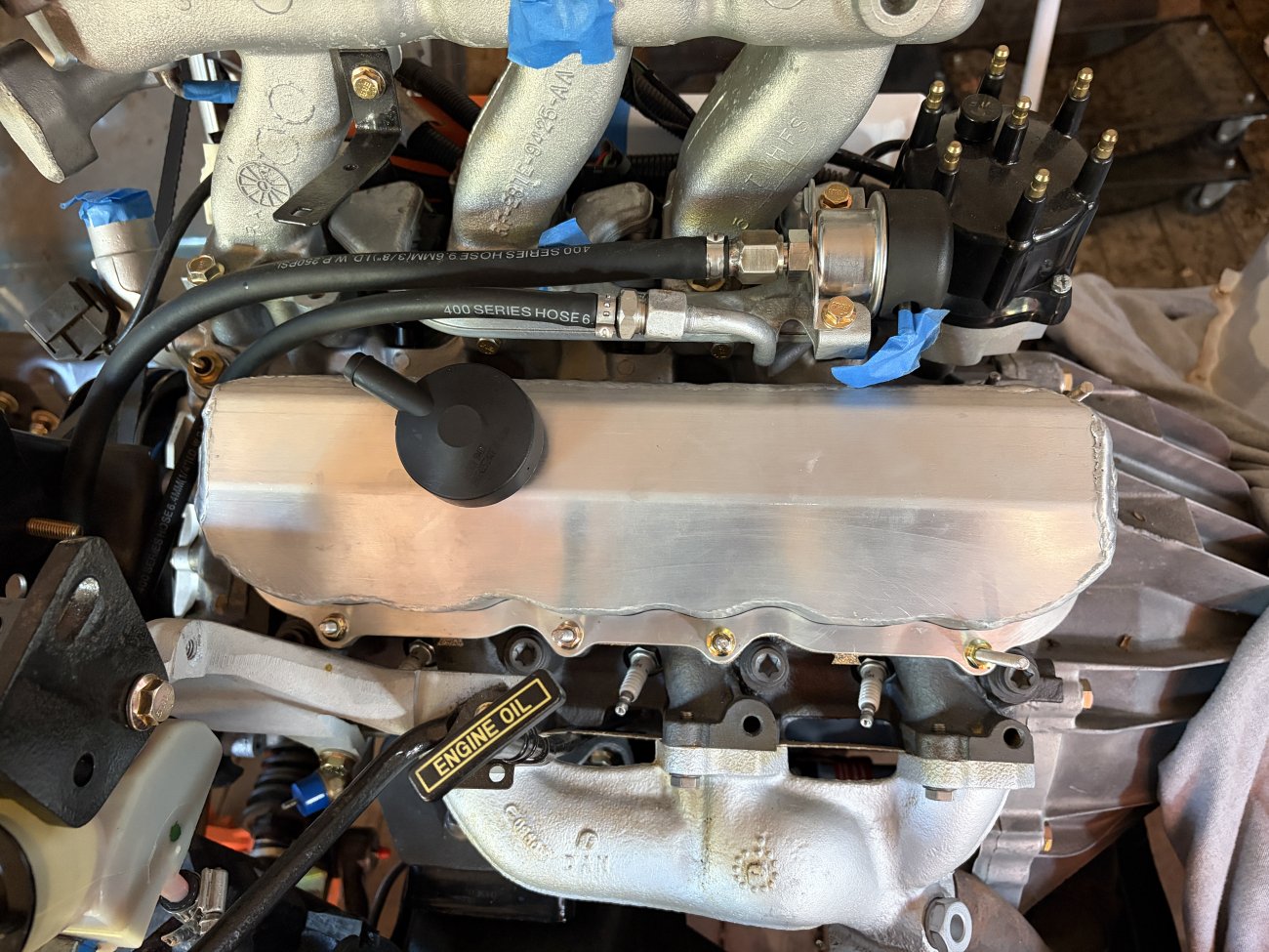

Just sharing a set of fabricated valve covers I made for my 92 2.9. My original were rusted through and its seems most of whats left out there has had similar fates. So I made a set. Its been a long process but they are just about done.
I would like to note that I am a machinist by trade, so go light on my fabrication ability. Grinders and paint make me the welder I ain't.😅

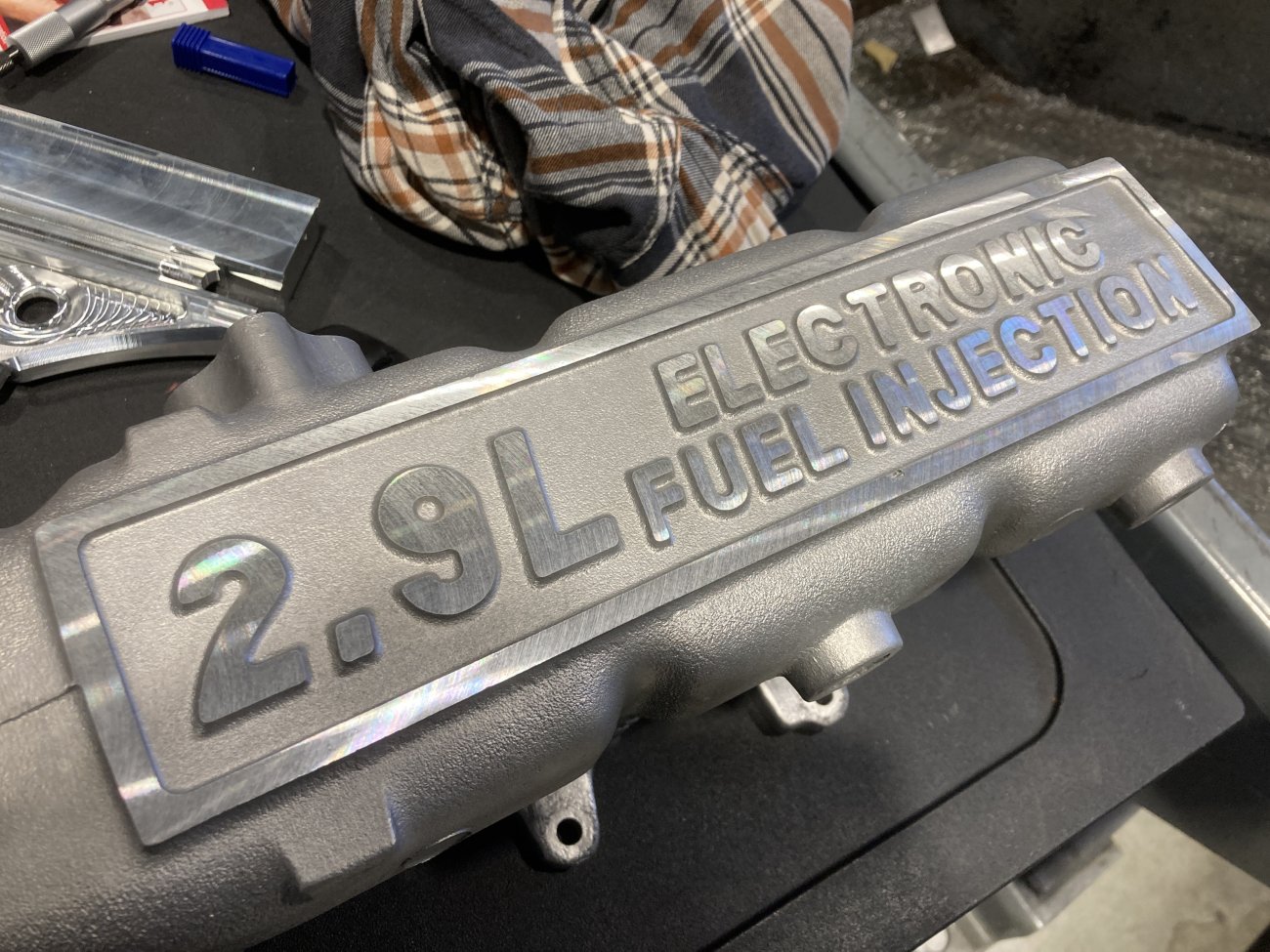

On a side note, I did take a nice pass over the lettering with a fly cutter. Give a week of driving and it will look like it did before I cut it.😂

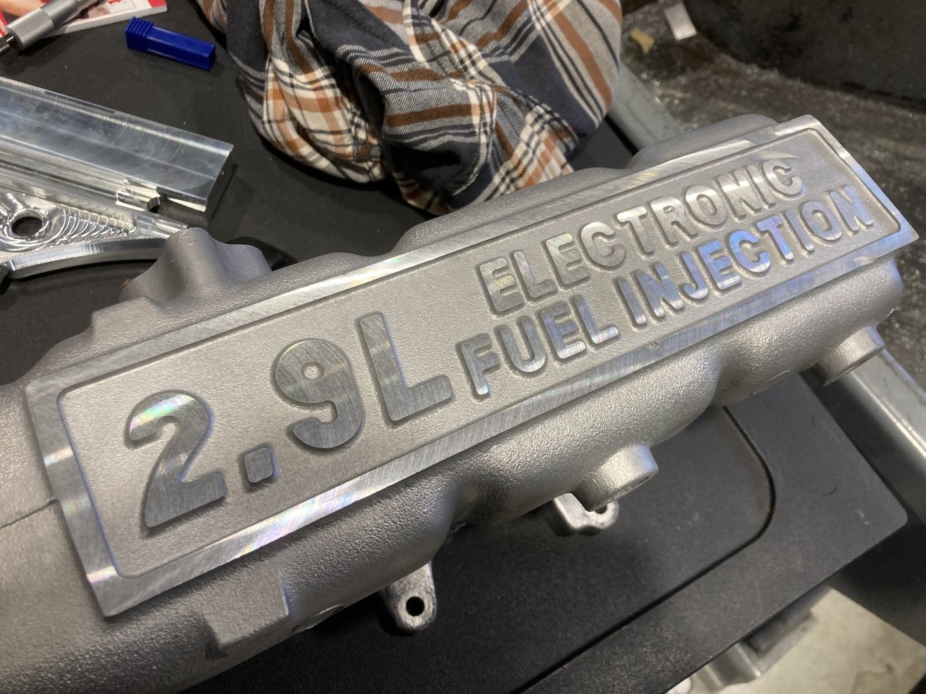

On a side note, I did take a nice pass over the lettering with a fly cutter. Give a week of driving and it will look like it did before I cut it.😂View attachment 145150

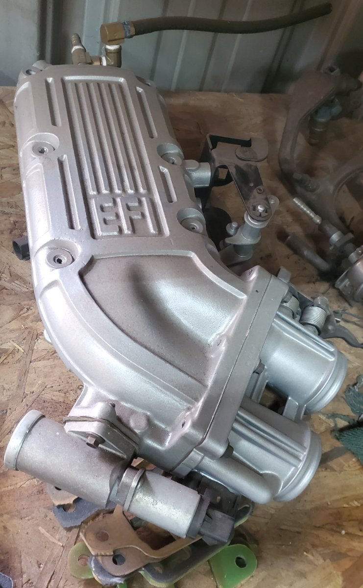

Scorpio/Capri dual snorkel. I had/have one on mine. Does make a difference.
Fabricated Valve Covers
I do have extras as well if your interest is piqued enough.
Does that replace the lower intake as well?
No, though there are several versions of them. Scorpio and Capri used a slightly different one with an extra coolant port for the rear heater. There is a ranger specific high-strength lower manifold available and I believe 1992 only. I do have one, but I'm not willing to part with it. The high strength manifold has beefier walls and a lot of webbing.
The dual snorkel upper will bolt to any lower
