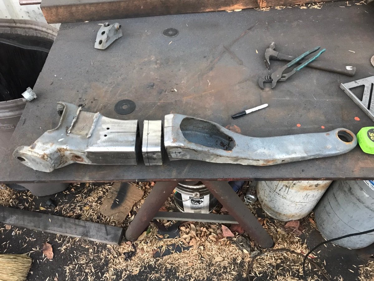

it is just a simple cut, extend and add material. heres an example of a +2"
between the 3rd member and the beam end obviously. youll want to extend your radius arms as well to keep em as far out as possible on the beam. also make sure your angles are right on the beam end for camber.
over lay plates on everything for strength obviously

What kind of steel do you recommend? Any validity to the extend the passenger axle first to mock it up centered in the window, or did you extend them equally?
Also, it looks like you simply extended the beam. There is no reason to rotate or turn the beam up and down since mine is already cut and turned at the lower balljoint, just not extended. Tbh I think they're just making it sound more complicated than it is so I don't just do it myself (and pay them).

extending it will change the angle of your cut/turn, as it is changing the diameter of the circle that the beam is pivoting on, but not by much. its something youll have to measure and angle the cut in your extension piece.
i only use cold rolled steel or chromoly for overlays. 3/16 thk rectangle tube would be fine for the extension piece.
Okay, so just thinking about it, it makes sense that it will effectively create more negative camber if they are linearly extended. Meaning that I'd either need to lift it more to bring the wheels back to vertical, or I'd have to rotate the beam slightly downward to avoid this. I actually selected a spring that gives me an extra half inch of lift, so I think I might be just fine extending it straight if the difference is minimal.
For the steel choice I figured using something softer would be preferable so that it doesn't brake if over stressed, but bend. The fabricator I spoke to recommended mild steel.
About the metal, I'll go with 1/4" on the extension as it's a diesel. For the plates i was thinking either 1/8 or 3/16. Not sure which one I should go with there. Was also thinking I should box the back where Ford/Dana decided to leave them open.
