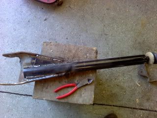

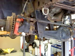

sorry for the long wait here are some pics
This Pic is before i set the caster angle

can i get a close up pic of the ra bracket. how you mounted it. you used the stock bracket right?
looks good man!
yeah that does look good, nice flex on it too
so the arms turned out great i have the skyjacker 8 inch Ranger coils and the arms did not help any as in flex with ranger coils. But now i can easily get a 23inch coil in my explorer and that is what i was going for. So im hoping on ordering jeep coils then it will be all worth it .
ill get close up pics tomorrow but all i did was move the stock R.A bracket back just before the transmission crossmember. Then i just drilled the frame. Now to set the caster angle i measured the flattest surface on both beams before i put the explorer on the lift. I lifted the explorer removed the coils then set the suspension at ride height with screw jacks. I then cut the radius so the DOM would fit snug. I then put the tube with the threaded end in the bracket tighten the nut. I then set my caste angle by putting a screw jack right where i cut the factory radius arm and pushing it up untill the angle was what i had before i started the project. Once i had it tack welded i took the arm out finish welded and add gussets then put back together. Before i started i would have to pry down on the axle beam to get my 21 inch coil in now I have to use the screw jack to push up on the beam so i can put my clamps on the coil :D
