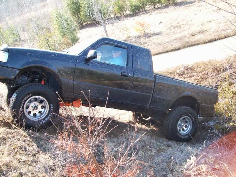

Plumcrazy, Ive checked mine at full droop. No issues with the frame, thanks for the idea. It took me a while to get my set done, But others and myself have found the discussion in this thread useful and thats what makes TRS so great.:icon_cheers:

You'll appreciate the increase in wheel travel.
