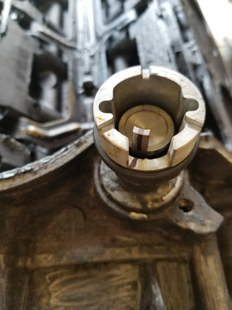

I think the sensor is the same it's just the synchronizer or whatever that pugs into the block that's different, the sensor is even the same as a 3L or 4L Ranger... There were a couple different styles, if it helps here's what was in my '00 I rebuilt recently to compare with what you have (yes, that's all I did when lining it up for reassembly, just lining up the sharpie line, pic is on disassembly which is why it's gross). I think if you change injectors and check the cam sensor you should be good to go with your plan.
Used engines are dirty, and if the Sharpie mark works there's nothing wrong with it. Assuming that you didn't touch the crank ( or it was lined up on TDC #1 before and after) the Sharpie mark should work just fine. The tool is mostly needed for new installation where the originan alignment isn't known.
That said, I'll probably have the tool when doing my rebuild (if I don't already have it).
Just noting things, I do sketchy stuff but have my limits :). That guy is a small diameter, I'd prefer larger since it increases accuracy but I'm sure it's close enough... yes, that mark is at TDC, the tool likely lines up the right side of the vane to the center of the window. Plus or minus a couple degrees shouldn't be the end of the world, I wasn't building a race engine living on the edge... I never know who is on the other end online, some people are bright and others are the dullest spoon in the drawer, I root for everyone so try my best to help out :). I learned a lot of things from here over the years, I was VERY green when I got here...
