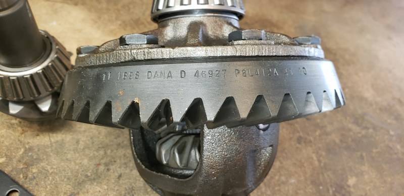

And it's really interesting that you say that, because the person who wants to sell those differential parts to me, had the issue of a cracked carrier, but the gears of the original are still fine and they're only asking 20 bucks for it.
I'll attach a photo I was sent of it. And it needs a new bearing because there's some pitting.
Now Maybe it's a pipe dream trying to get inexpensive 4:10 gears, and I should just forget about it. Shortly after my original post, I came across a listing, that's a lot closer, still far away but a lot closer, for somebody selling an explore axle width the drum brakes and everything ready to go with the same gears I already have. Maybe I should just do that alone and be done with it. Less headache and I'll have my Ranger on the road sooner. I'll just have to be careful what I tow when I finally buy an RV trailer.
