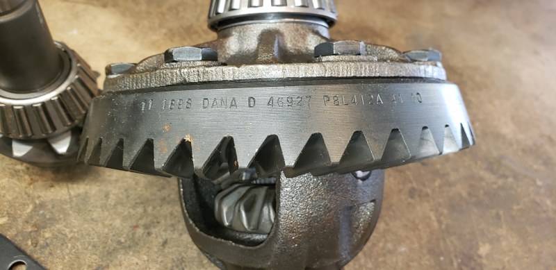

And it's really interesting that you say that, because the person who wants to sell those differential parts to me, had the issue of a cracked carrier, but the gears of the original are still fine and they're only asking 20 bucks for it.
I'll attach a photo I was sent of it. And it needs a new bearing because there's some pitting.
