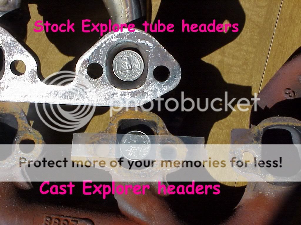

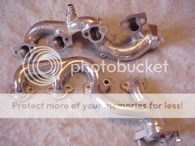

I think the Mustangs have used 409 SS tube headers since '87'. I think it more a matter of flow design than the material in what you call it. The old Maxi-Wedges ran what was called headers but were cast iron. Anybody what to see some good pictures of the Explorer tube headers? I toss mine right away.

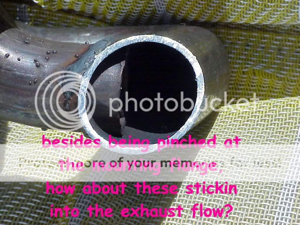

:D What Ford called "Headers" didn't appear til the 85 model year. And they weren't exactly "free flowing" :D They're all somewhat "pinched" at the head ports to gain clearance for the factory bolts. They're pinched in various other places too, to gain clearances for other reasons as well.
Pinched ain't the word for it,I never really looked at them after trying to make them work for so long till I scored the Hookers.
Had to rework the collector on the Passenger side but well worth it.
Maybe a better picture of the pinched stock tube headers and the cast iron versions.
