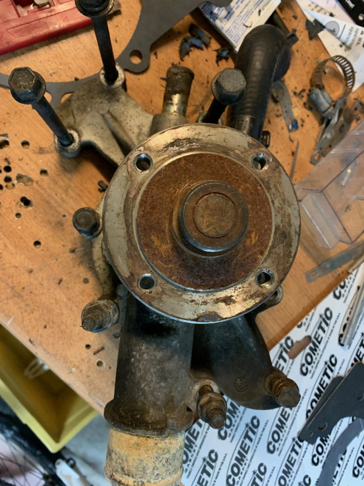

Don't know if this will help, but I happen to have my water pump off the FEAD (Explorer) and took this photo so I could put the bolts back in the correct holes.
53094
Actually, it does help. Would you mind letting me know the length of each of those bolts?
Thanks!
Oh crap! I just put it all back together tonight. Sorry.
