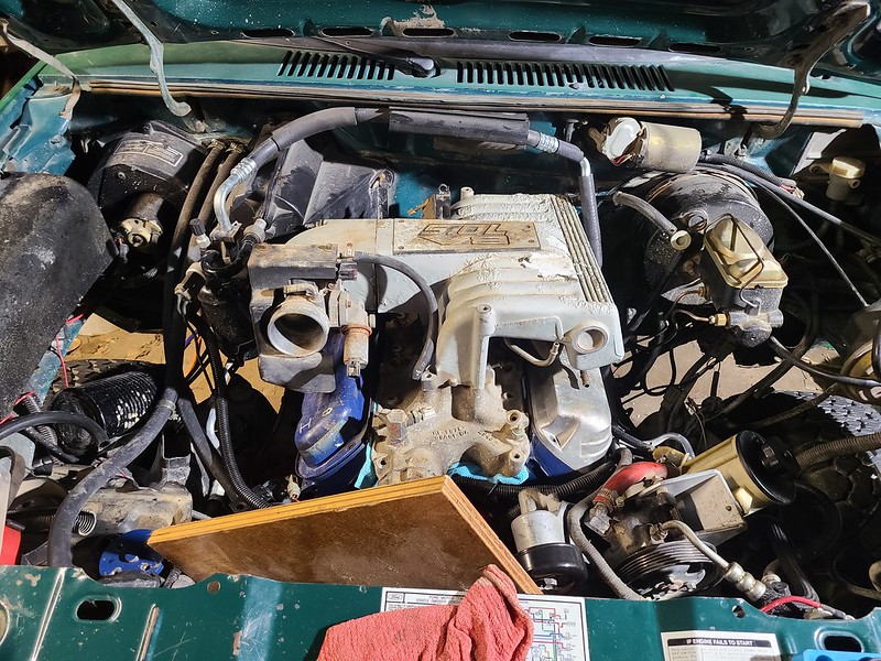

Engine is a complete hodge podge but does have the Explorer pulley/front drive.
I really only have the Explorer intakes, if I cant get something figured out there really nothing else matters.
The Explorer intake puts the air cleaner where my battery is... which is less than ideal.
Explorer EFI into a first gen
I played with it last time I had the intake off, not really a ton of room to work with.
I was planning to relocate the battery box to the other side, but I was also a lot deeper into modifying that truck than you're doing.
If I could get something like a 4.0 airbox to line up and if it flowed enough to feed a 5.0 I think it might work with my planed electrical system upgrades (all my added electrical stuff is under that plastic cover on the PS fender.
