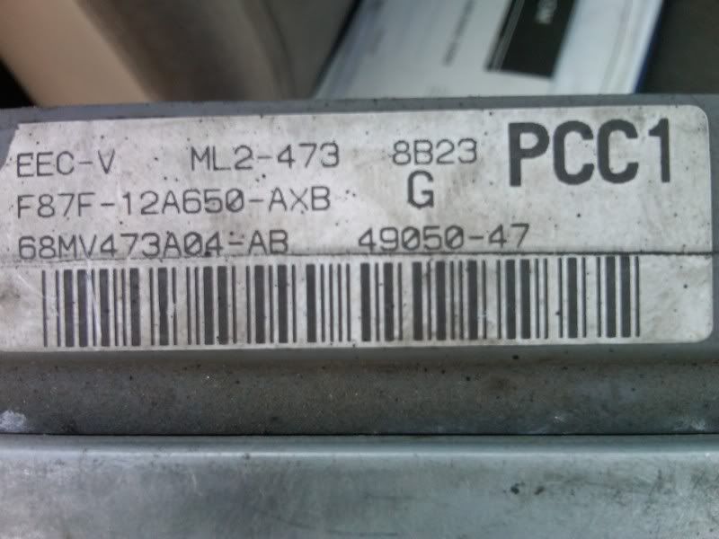

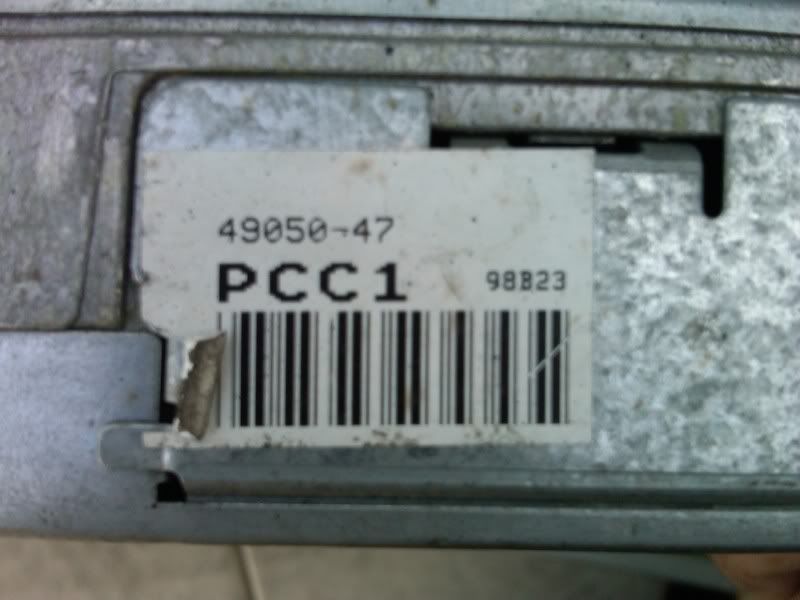

Sorry to bring up an old thread but my quest to find a 1998 Explorer 5.0 PCM wiring diagram and pinout brought me here.
I was able to find a '96-97 diagram online... but cannot find anything for a 1998... which according to this thread is unique in comparison to the 97s and 99s.
Can anyone out there with access to Alldata or factory Ford literature help me out? A friend of mine has swapped this motor into his first generation Ranger and we're hard pressed to find the diagrams we need.
Thanks in advance! :beer:
Also, not sure if it helps, but here is the info from the stickers on the PCM
