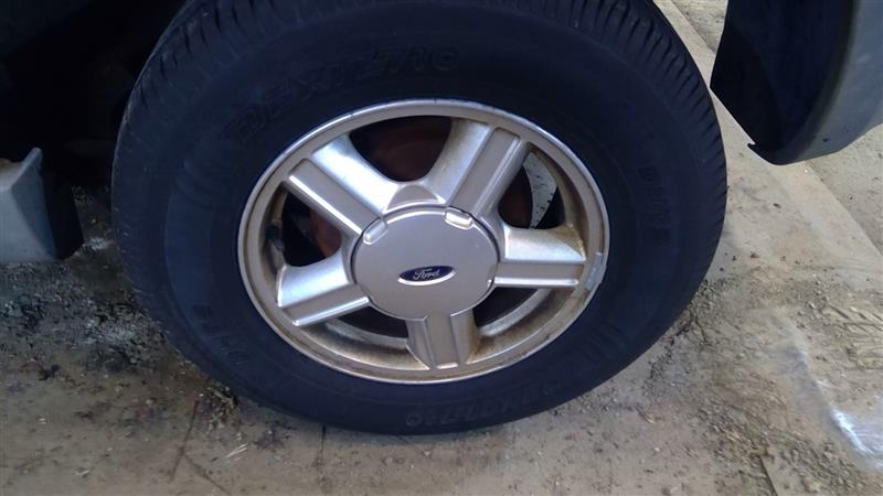

You do not have a 2001 Explorer wheel. They may have been installed on an Explorer, but they don't match any wheel used on the '01 Explorers. The picture you posted is a good match for 2001 Escape wheels, and it had the same lug pattern. Be careful about fitment on those, they have the right lug pattern, but they are actually a 15x6.5 and they have a much different offset than what should be on a Ranger. The offset will pull the tire in towards the center of the vehicle by 1 inch to 1.5 inches.
This is what your wheel and center cap should look like:
These center caps use a similar lug nut to the ones that @sgtsandman posted, but I can't say if it will work with the ones that fit the Ranger. The Escape used a metric wheel stud vs satandard on the Ranger and Explorer, there is no good way to verify if the retention lip on the nut is the same size without having both lug nuts or just trying it.

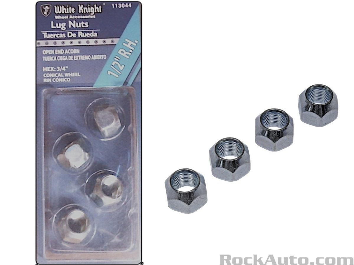

The factory lug nuts should look like this. The center cap should clip onto them.
I have been looking on line for these and am having a difficult time finding a set. I made the mistake of buying ”one” for $17.00 thinking that it was one “set”! So, does anybody know where I can find them at a reasonable price like a few bucks a piece. It seem everyone on line, eBay, sells 1 for a ridiculous price. I have already gone to the local junkyard and found one out of several hundred that I search through.

Wow! You in a matter of minutes showed me how weak my searching has been! Thank you very much.
friendly FYI, those nuts can also be found on some Crown Vics. usually with the steelie wheels and cheap caps.
Ouch! I hate people that list stuff like that.
Even if you don't manage to get the clearance ones, that site also sells them in 10 packs @ 79¢ each. Not quite as good, but not terrible. Figure on adding around $10 for shipping through RockAuto, at least thats what it usually is for me.
If you don't like ordering online your local store will likely have them for around $4 each, but might have to order to get quantity you need.
Thanks everyone! You all have been very helpful. I ordered them from RockAuto at the $.51. They have shipped and should be here next Wed.
