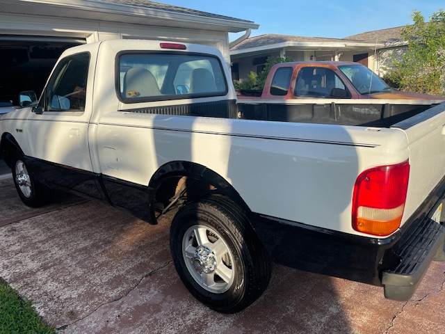

@don4331 the 2001 Escape that those wheels are from were 5x4.5 bolt pattern.
He won't need to worry about "hubcentric" spacers, just get spacers without the raised lip that center the wheel. He'll be running the wheels as lugcentric which won't be a problem. Being hubcentric is a lot more important for wheels that have a flat lug seat like on my old F-250.
I completed the first phase of this. Haven’t got spacers to correct the wheel offset.
