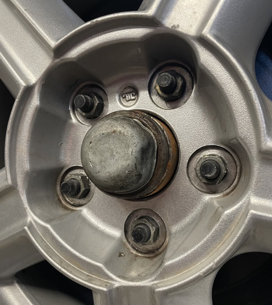

I bought a set of 2001 Explorer alloy, 5 spoke wheels, 15X7 for my ‘97 Ranger which had 14” wheels.

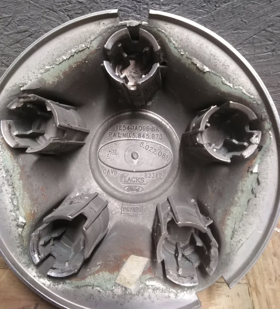

I then bought a set of center caps as the new wheels did not have them. I received them and they have five plastic collars inside which look like they would slide over the lug nuts or bolts. However, there is no way the lug bolts are long enough to reach out to hold the center caps on. So, I guess I am missing some hardware for attaching these center caps to the wheels. I have looked in many places but can’t find any information on how these were originally held in place. I guess I need to send them back and start over.

Thank you for your reply. The lug bolts on the truck look like those, but I still don’t see how the clips on the caps could clip on the lugs and hold, as there is about a 2” space between them.

I’m betting he has the flat caps that the 02+ Explorers usually used. They aren’t deep enough to cover even the front dust covers on the 97 and older 2wd, much less the 4x4 hubs. Those flat covers only work with the 00-11 Rangers to my knowledge. The live front axle or 2wd trucks. He needs a deeper cover and/or to cut the covers for the front.

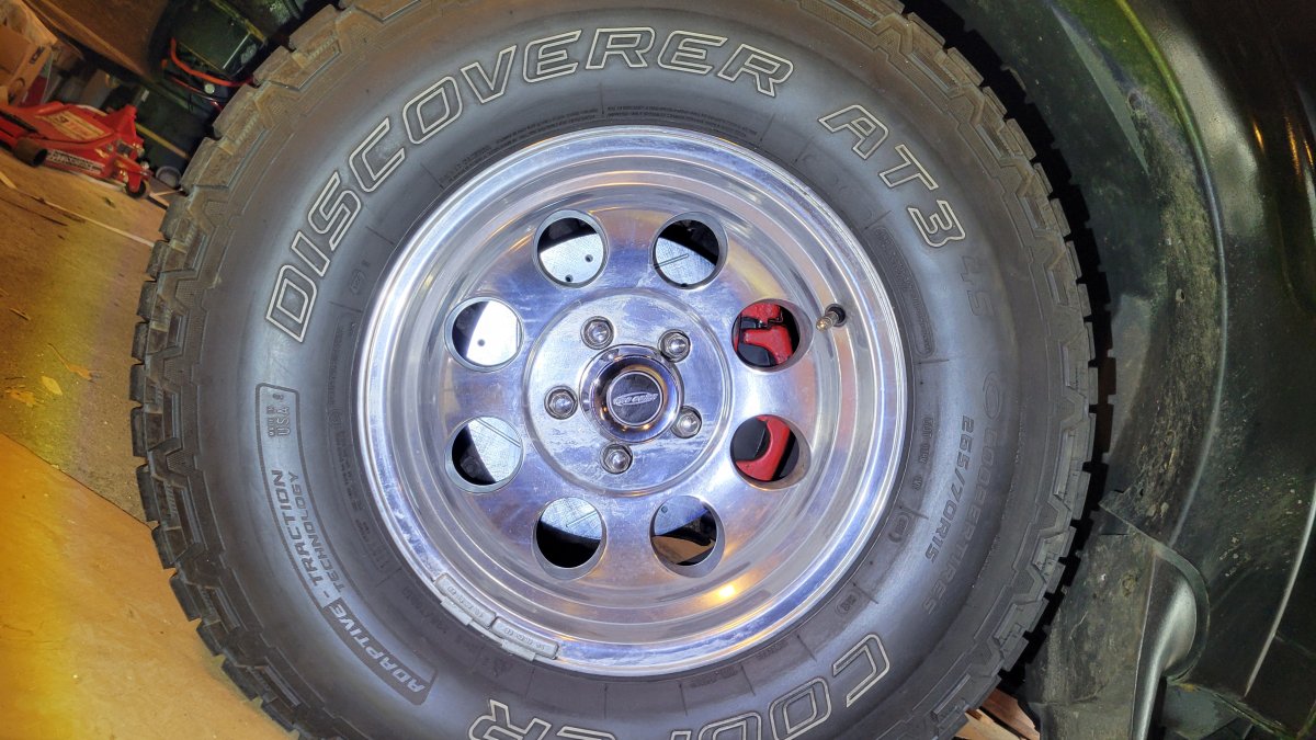

Whatever the case may be, I tossed out those rusty old steel wheels and bought new aluminum which came with caps that just won't come off. New wheels and caps might be expensive. Mine were Pro Comps which cost a very reasonable $150.00 ea.

Here are pictures of the wheel and caps. They are supposed to be 2001 Explorer, but I really don’t know as I bought them both used. The caps sit right in the center recess, but the retaining collars do not extend into the wheel area to come in contact with the lugs nuts.
