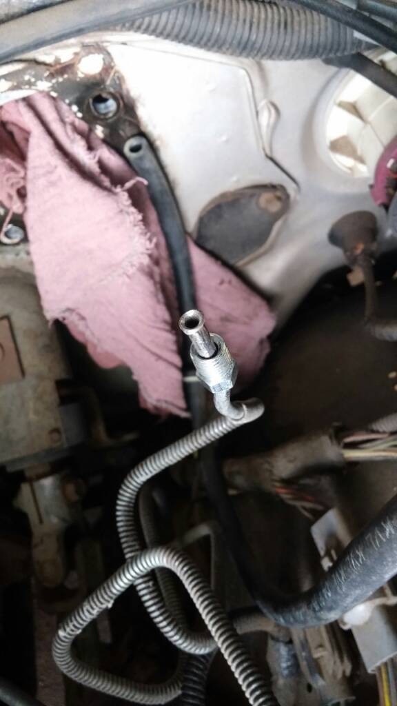

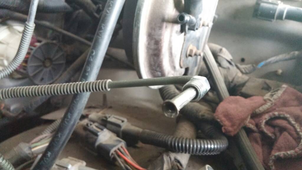

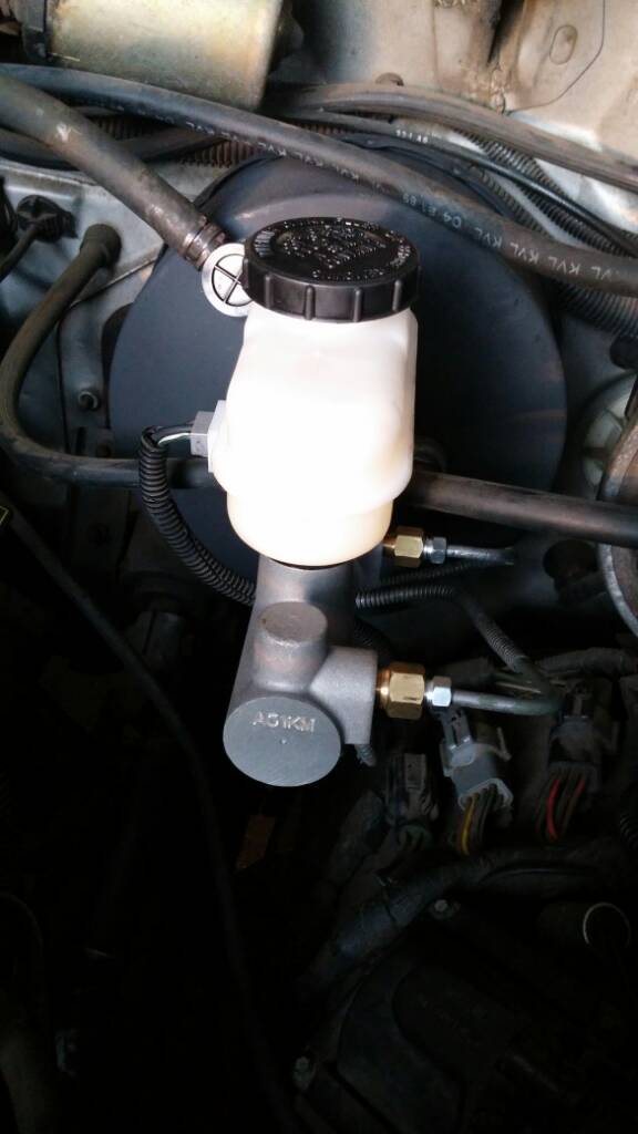

Took a couple of hours, but finally got my lines cut and flared with new size nuts for my line adapters on my explorer m/c. New booster, in, which was the problem. Now bleed lines next.....
