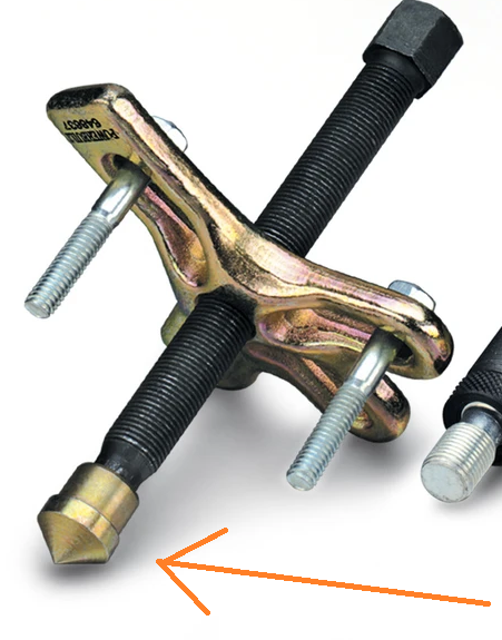

Honestly there's a strong chance I'll be bringing the '99 to Indiana without the new axle at this point. Every step of the way with getting it running has been madness. Yesterday I had to rent a right angle drill so I could drill out the end of the crank and tap it to a larger bolt for the harmonic balancer... In case you've ever wondered what happens if you forget to put the cap on the end of the puller after a long day of wrenching, I now have first hand experience. It can thoroughly destroy the threads of the crank. Good times.

Crank issue is fixed now other than needing a slightly shorter bolt. Tapping it to 3/4-16 sorted the problem out nicely.
