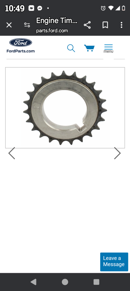

So this little bugger here behind the timing cover has to line up with the same " keyway" or whatever on the HB ?
Be cause I never removed the timing gears
