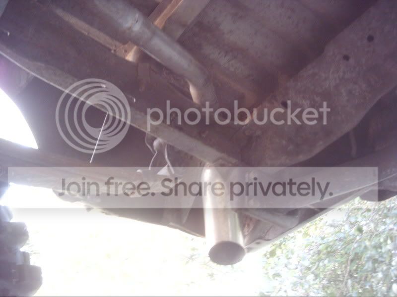

To all wondering ways to do your exhaust on a 4.0, here is a few ways I have found works good and sounds good ... I work at an custom exhaust shop, so I have tried many different ways and these are the 2 best i have found. Mind you I do NOT have converters on my truck ... any truck 95 and older is not necessary minus for emissions purposes
4.0
1) come off the Y pipe with 2.5 in pipe into a single in duel out 40 series flowmaster or equivalent muffler use 2.25 in tail pipes with either 3in or 3 1/2 in tips
2) come off the manifolds or headers with 2.25 inch pipe into a duel in duel out 50 series flow master or equivalent using 2.25 in tail pipes with 3in or 3 1/2 in tips
3.0 and 2.3 (of course on a 2.3 you can not use option 2)
1) come off the Y pipe with 2.5 in pipe into a single in duel out 40 series magnaflow or equivalent muffler use 2.25 in tail pipes with either 3in or 3 1/2 in tips
2) come off the manifolds or headers with 2.25 inch pipe into a duel in duel out 50 series magnaflow or equivalent using 2.25 in tail pipes with 3in or 3 1/2 in tips
Remember these are just ways at our shop we have found out that it works and sounds good .... I am NOT by any means saying that this is the only way to do it. every one has their own way and ideas here is a few dirty pics of mine with the duel in duel out set up.
