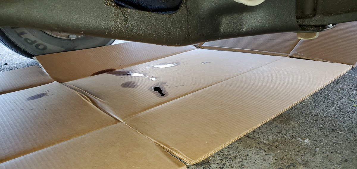

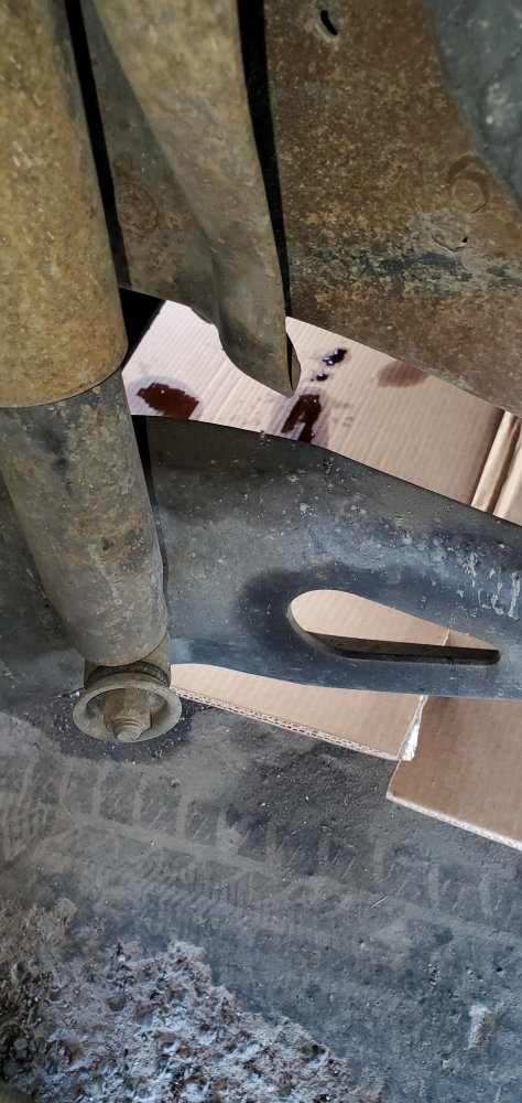

Also, here are some pics I took of the cardboard and where the drips are. I assume the wide pattern is due to the oil dripping on the frame. The parking lot is angled so that the nose is sightly up. This was after a 30 mile drive at around 70MPH but it was not cleaned beforehand so there could be residual oil from previous trips. First pic is from when I just put it down. The rest were taken after it was parked 13 hours. The last pic was taken from behind the passenger wheel looking forward. As you can see, it's losing a lot of oil.
I'm concerned that the drips in the back might be from another source. Can oil really travel that far on the frame? Maybe it blew back when the truck was moving?

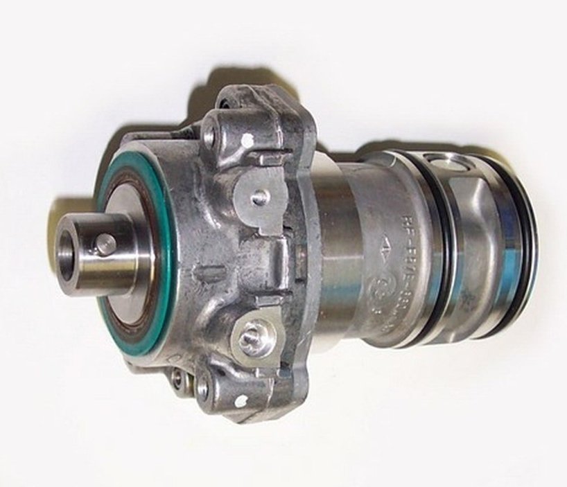

I was able to find these diagrams on another forum so it looks like the part in the first pic is the pump. The line of oil came from the top and was running down near the back.
Here's a pump from the same angle. It looks like the part that sticks out of the aux hole on mine is clean so the leak can't be coming from there.
